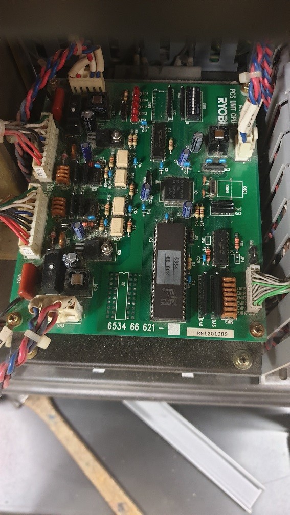

Hi,
Thank you smalloffsetpressexperts, when you mentioned about the unit CPU Board, you were referring to the board that I have uploaded below thank you.
