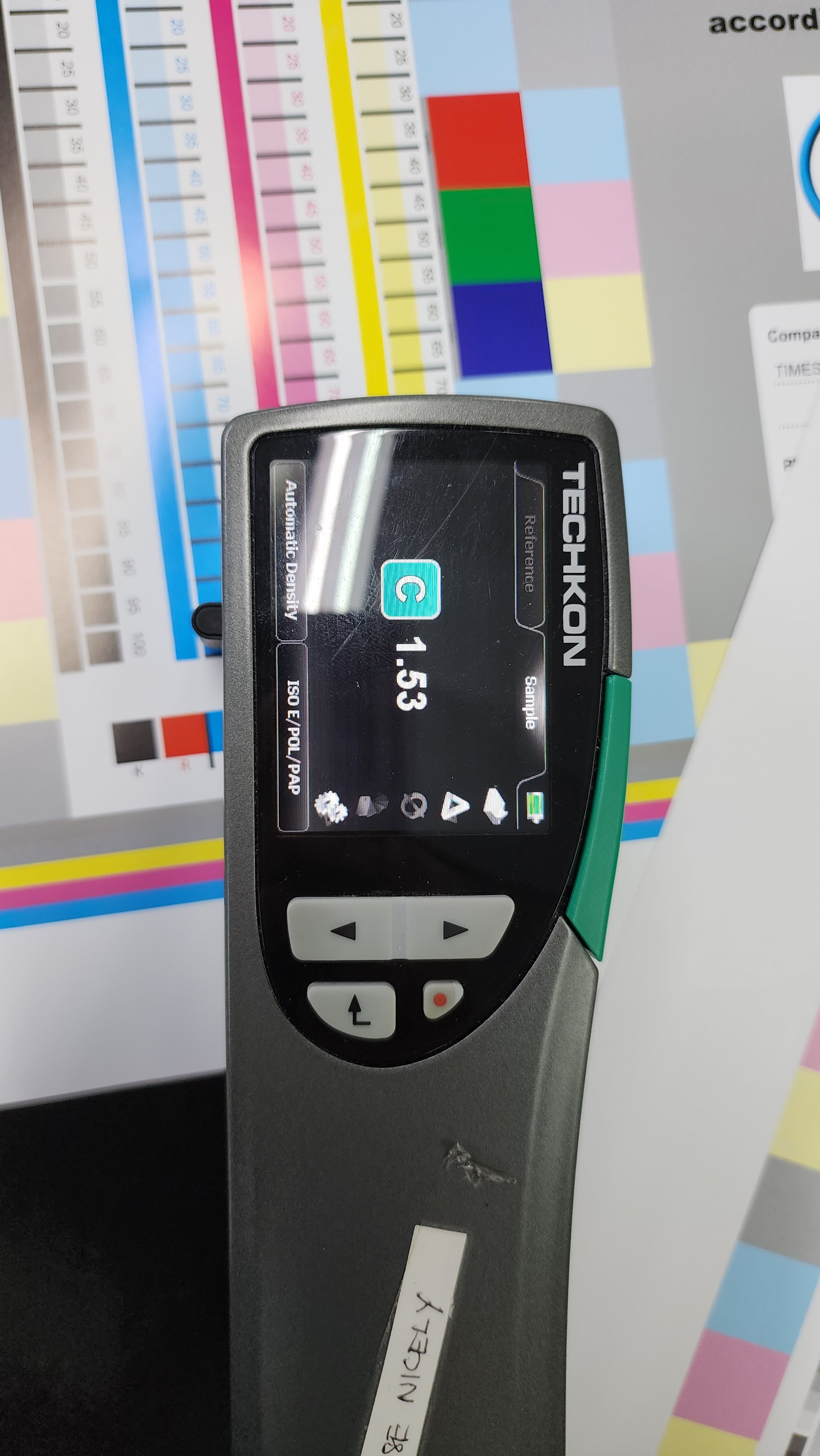

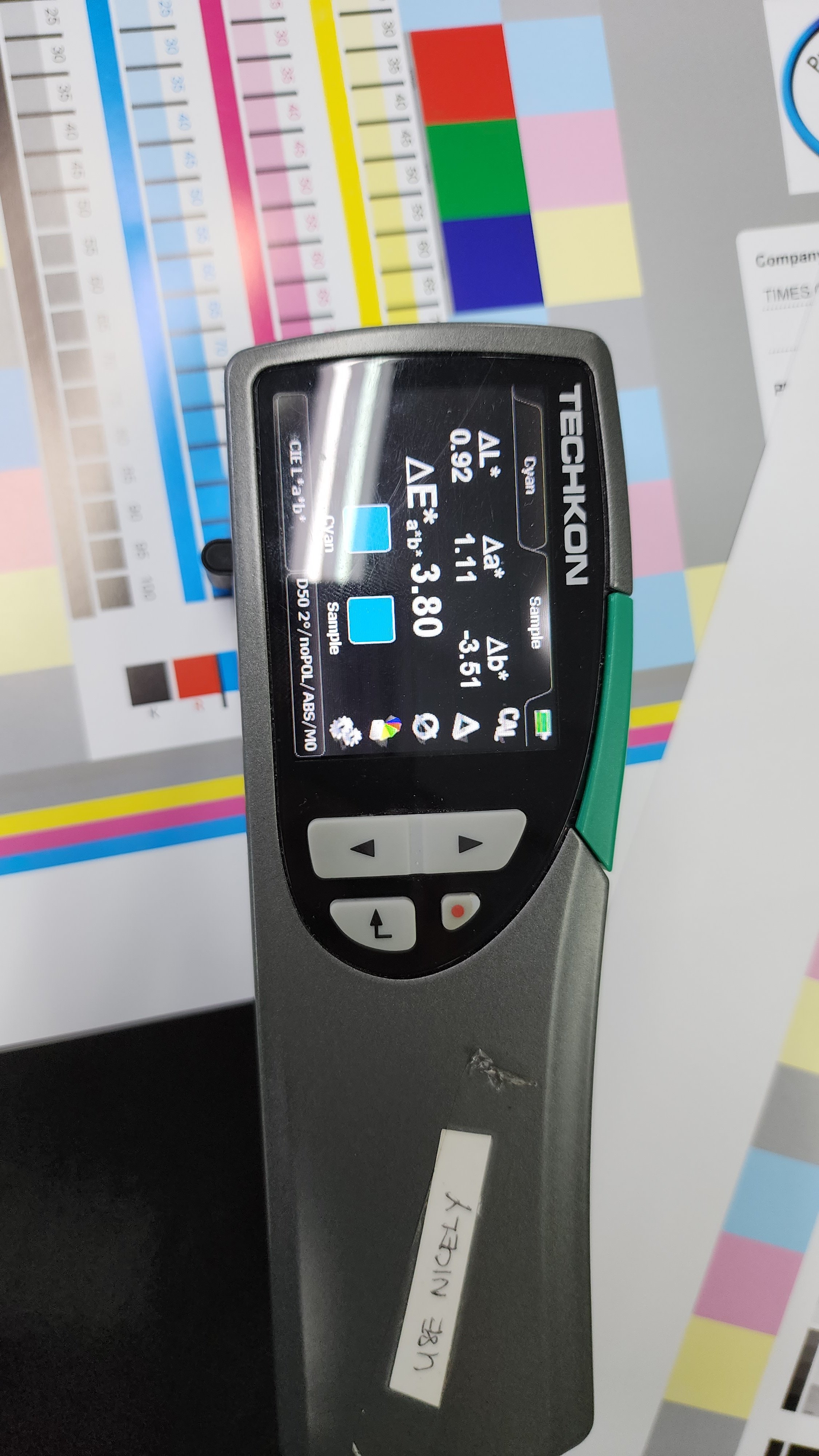

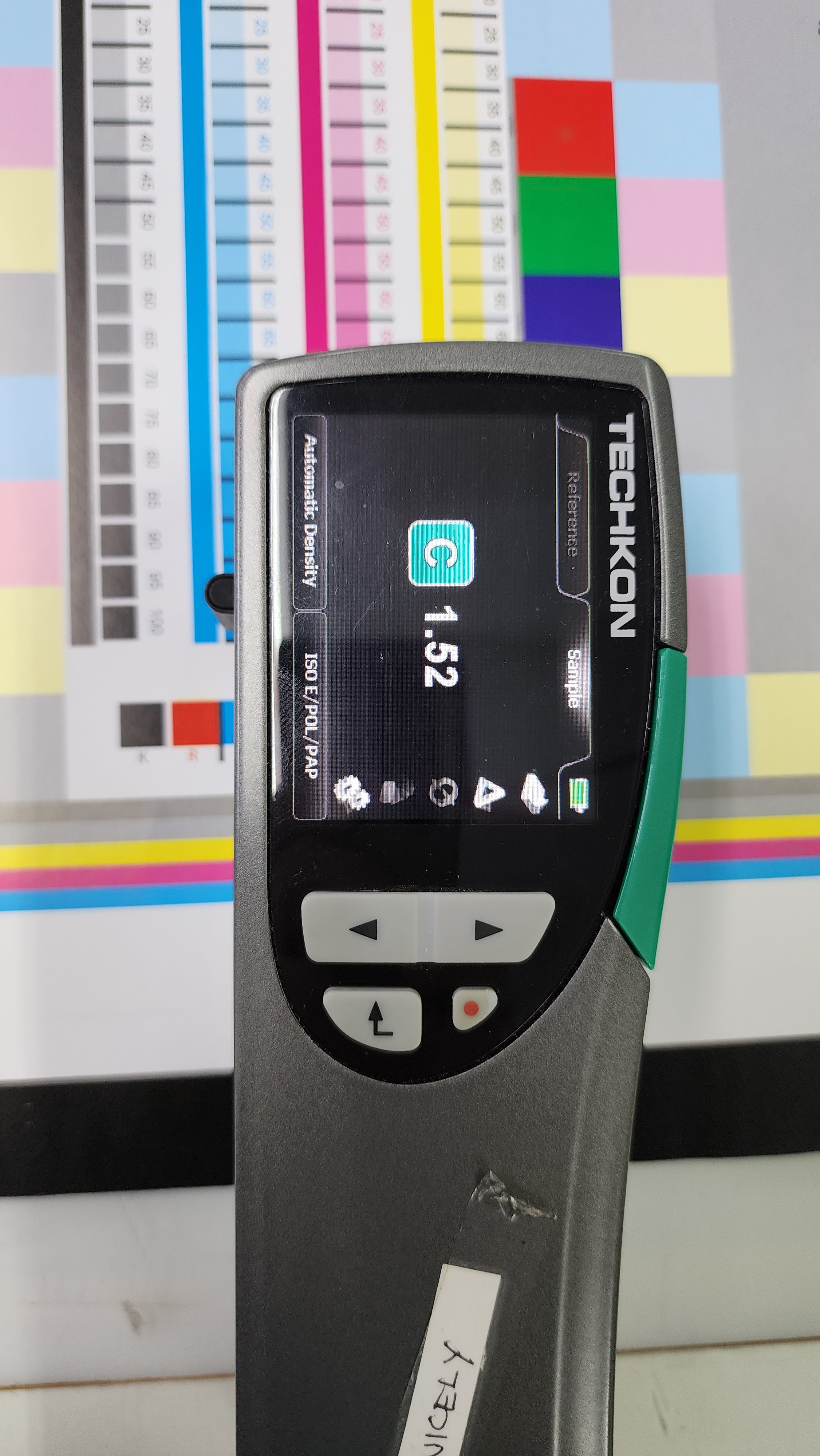

I would like to ask what factors can affect the lab color value of the solid ink density? We are using same ink for both press. Any press variables that can affect this?
Rmgt
Roland
