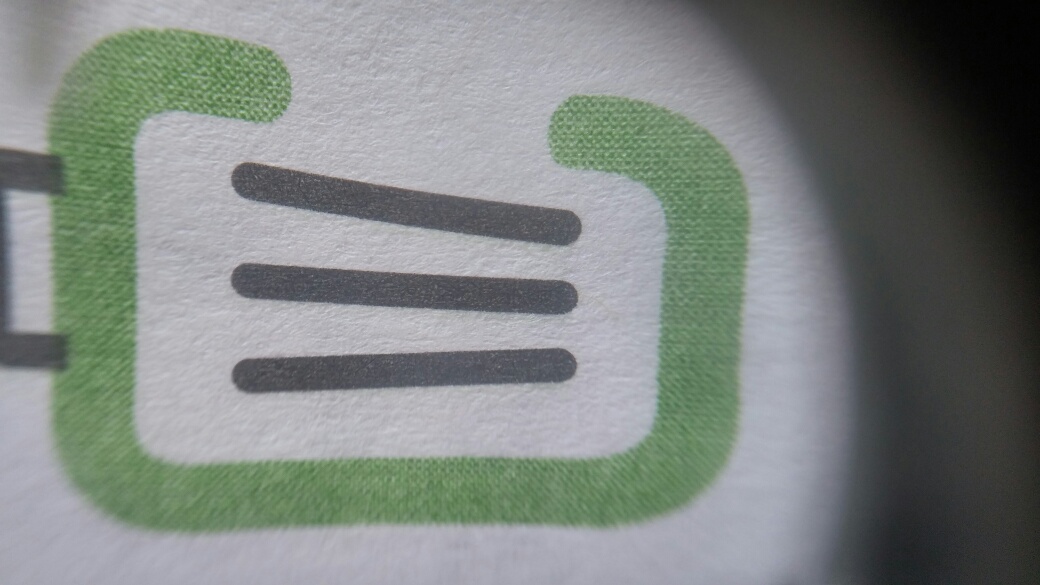

We've been having this problem since a long time ago.
The black is screened to 77% - no problem
The green is supposed to be solid.
It's solid on the file and on the screen on the image setter RIP computer.
Imagesetter : Agfa Avantra 25
Press : Itek 3985 two color.
150lpi / 4000dpi
we tried to switched off the plate and see on pic #2 for the result.
The lines are still there.
Is it file problem or image setter problem or press problem ?
Thank you

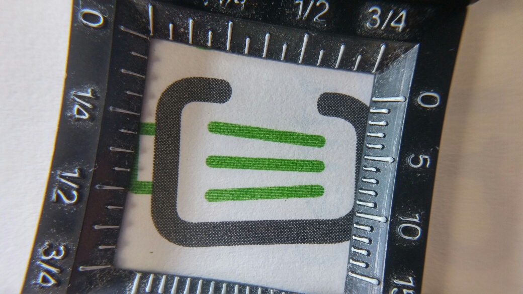

updated with real logo on file (pic #3)
solid spot color green

We still need the original file to give a reasonable guess . . like an illustrator file - if its in photoshop thats probably the problem . . . but no file no good answer

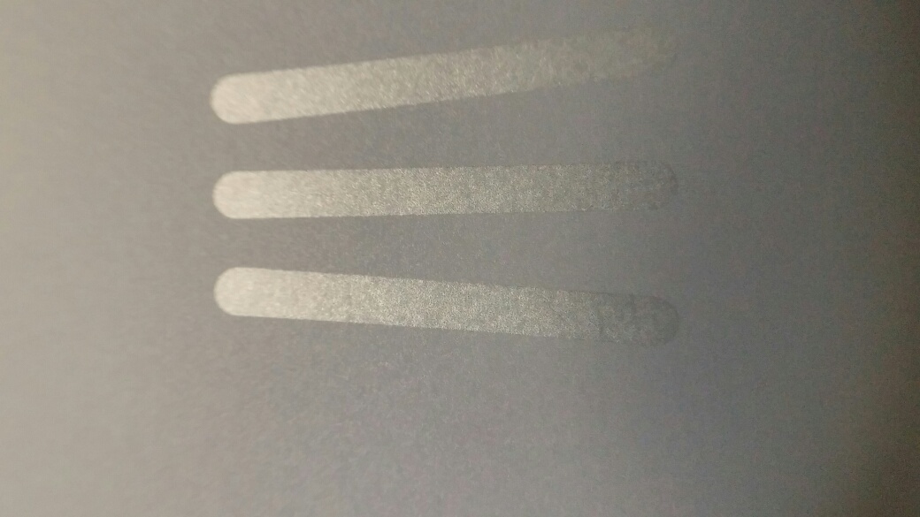

both black and green are on 45 degree.... just realized, this might be the problem. But the green is solid, does it matter ? This problem shows on every job. I thought it was blanket problem on head #2, apparently not. Attached picture of actual plate used (cleaned, but there's a bit of black ink leftover on it) - it's a polyester plate. To me, the plate looks fine, solid, there's no line pattern on it.
original file was created in Illustrator (PDF). Vector. I can't embed any file other than JPG/PNG

Thanks. I posted the plate picture here. The plate looks perfect-solid, no lines

No, it happens on head #1 too, you can see the pic on my first post when the pressman try to switch the plate.
