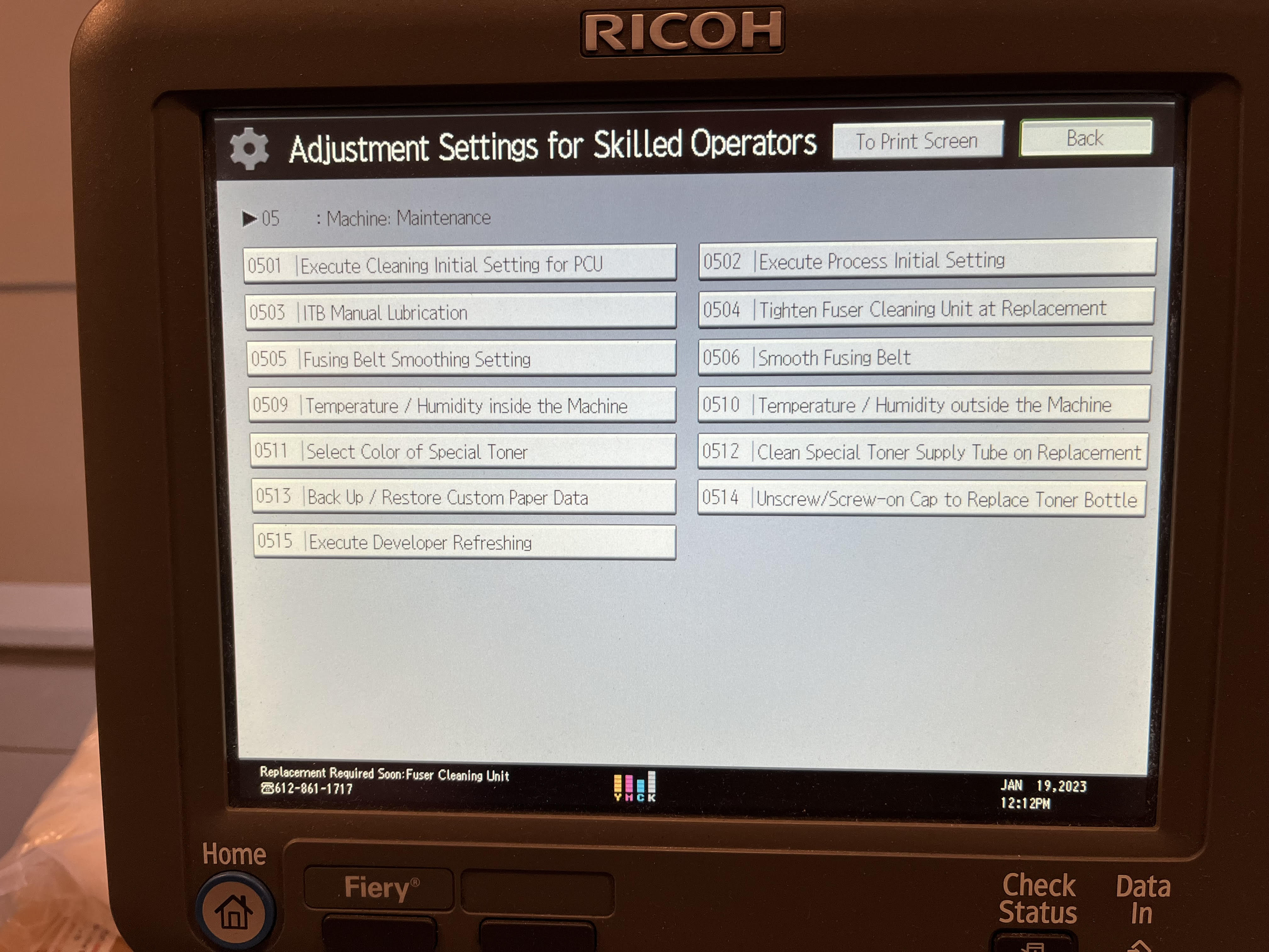

Skilled Operator Menu Ricoh 7110 Fuser Cleaning Unit
I use admin login to do this, ask your tech what the passcode is if there is one, might not be one unless it was set by previous user.
That is simpler than I thought. I'll try to log in again. I know the password is Fiery.1, I'd assume the username is admin. Thanks for the message.
you're confusing the password of the fiery controller with that of the onboard engine menu (probably not the correct terminology)
by default the password is probably blank with admin as the username.
You are right. I might have typed it in when it was already logged in and thought that was the case. Thank You! Very helpful.
I am guessing this isn't under maintenance contract so you don't have a tech that can fix this? My thought is it needs to be turned on via the tech login.
This machine, I do don't. I do have a company that will come and fix it on request. Kind of annoying just to reset the clock.
