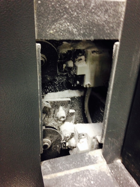

Another thing to check are the two switches on the delivery pile up/down chains underneath the OS cover (above and to the right of the spray powder unit). Most people do not know about them because they are hidden well. You have to reach your hand way up in the cover to get to them (we cut a hole and make a little door, the newer presses have a little latch). The switches have cams, if your delivery is dirty with powder these can stick sort of in between where they are supposed to be and cause the quick pile down to not work. edit- quick pile up will not work either. Here's a pic of the switches:

Good luck man, delivery pile problems can be a hassle but luckily it's usually something simple.
Mike
Mike, You the Man!!! It was the chain switches on the OS. Thanks for all of the other CPC info. I'm always curious about what that stuff does.
