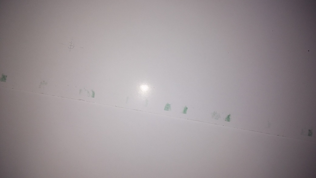

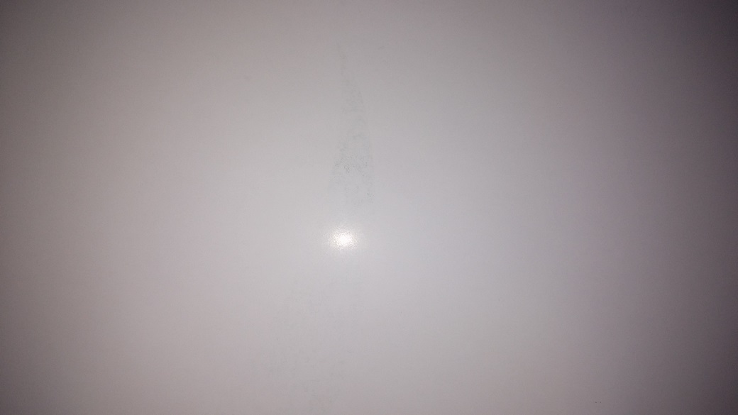

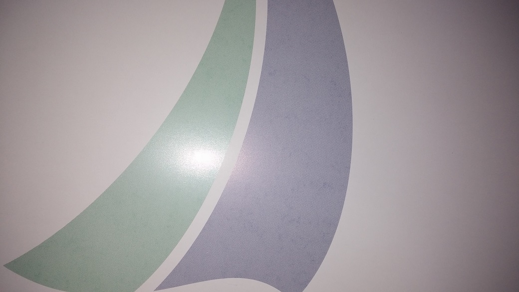

Hey everyone.. we had an sm74 installed not long ago. It is not a new machine.. but new to us.. and we are having a really frustrating problem that we cant seem to shake so far.
The press operator is sure its scuffing, but we cant figure out why... the press was installed with orange transfer jackets.. but whether the jackets are on.. or off... we have the same problem.
One of the attached images shows what it is doing to the print, and the other two show what it is doing even with the impression turned off completly and just running sheets through the press.
This job in particular is a pantone screen.. we have had some success running a solid pantone, but when running screens, and process solids, we have real issues with this and hoping someone can help!!
(hope you can see it in the photos, it is not as bad as it gets if we continue.. it gets much worse as it goes.

There are several things that could be causing this problem. Try to eliminate them one at a time
1.Is the suction bar on the double transfer set to hold the tail end of the sheet, and working properly? Try sending some already printed sheets thru the press with the impression off and with the compressor on. After you get the stream of sheets into the press hit the emergency stop and check the sheet travel and see if the suction on the tail is working. If the sheet is not being held at the tail, you could have the sheet moving around as it comes into contact with the transfer jacket. Check to see if all air bars are operational. Compressors might not be turned on from the console.
2. Check the packing under the transfer jacket. It should not be too tight or to loose.
3 Check the sheet travel as it comes up thru to the delivery if it is SM74. The sheet should travel along the venturi guide plate un disturbed.
4. If you are running this jobon a 5 color in the 1st 4 units and leaving unit 5 off. Try turning on the impression on #5 unit. This will stop the sheet from fluttering.
These are a few things that you can try to troubleshoot the problem. By the way what kind of SM74 is it with regards to number of units?

For example, in image 2 supplied by the OP. There are two sheets shown in the image. The leading edge of one sheet is shown in this image. This leading edge shows traces of ink on it. No ink should exist on the leading edge of a sheet. It is within the gripper bite and is a non-printing region. So how did the ink get there? Are the grippers so dirty that they are leaving these marks on the leading edge?
So here's my point, ink on the leading edge of a sheet, may indicate that the leading edge of the sheet is being delivered in such a way that it lands on the sheet prior to it, and scrapes/scuffles past the wet ink on the surface of the previous sheet.
A sheet should be brought all the way to the joggers at the end of the delivery, before being released and stacked.
If a sheet is released too early on? Then it strikes/scuffles the sheet beneath it and scrapes upon the ink surface of the sheet beneath it.
There should be a delivery lever that controls the timing of the sheet release. If the sheet release occurs in such a way that it strikes the front joggers prior to striking the sheet beneath it? Then that's the way I believe it should be. Why deliver a sheet in such a way that it strikes the wet ink on the sheet beneath it?
Bring the sheet to the end of the delivery and then blow it down with the fans in such a way that there is a slight upwards bow on the edges of the sheet, dipping in the center.
Scuffling of the type I'm speaking of, always occurs on and within the first few inches of the leading edge.
If you're not perfecting/straight-transfer? then there should never be any ink on the leading edge of a sheet. Gripper marks? Yeah ....ink ...no.
Hope that helps?

Good call Alois,on the e-stop while printing at speed. Note to Cameron, check for any possible oil that may be flying around. Also check for dries ink on the perfector. One other thing I would like to know. The sample that that shows the random color bars looks like a slap off a blanket that is not under impression Does the press have a coating unit?
Thanks for the replies everyone, sorry for the misleading picture 'otherthoughts' it is the tail of the sheet, i was just laying them down to take a photo.
We have been keeping an eye out for oil flying around, I think we are ok there, and we have tried the estop, and checking both the perfector and transfer cylinders/jackets.. the perfector looks good, with the cylinders they are buliding ink on them, with the jackets on they are building ink on the jackets... we are trying to get superblues here asap to try those instead, could be that these orange jackets are just junk?
You are correct about the blanket not being under impression... for those sheets showing the color bar impression..
