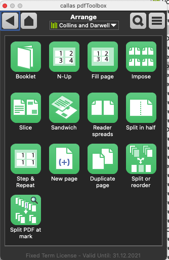

Quite Imposing. It's relative to what you consider 'inexpensive'. There might be a trial, so you can try first.
Thanks Keith, I remember that software from my litho days :) . Bit too rich for my blood at the moment, sure its worth every penny, looks like it'll be the manual approach for a while longer :) I'll keep that software in the memory banks.
keith1
Use the trial for a month - it's free! I use it 'quite' a bit (see what I did there :) to resize pages. Like when people send business cards on a pdf page the size of a football field (almost).
Maybe others will have suggestions that aren't so pricey.
djdjoric
If you have InDesign, you can setup a template for both of your needs (spliting and imposing) and than just replace links every time you need that kind of task, and then print to imposed PDF spreads using InDesign's inbuilt print booklet feature. I did that a lot when i was working on digital machines. It doesn't take a lot of time to do it and no need to buy more software.
There is also this script IDImposer Overview : InDesign Tools. Free for smaller jobs, about 20 bucks for larger load.
Hope this helps.
scotts
If this is always the case, you could check Fiverr and have some write a Python script that will do it for you. And would probably only cost you $20-50 US. Then you will always have it, and no extra software to buy. I've used it for something similar, but it was a one time only project, but it was a LOT of files, and it was well worth the money.
SoggyWinter
Montax Imposer is a good tool. You could run it in a virtual machine on your mac or rent a Windows Virtual Desktop for a short period.
prepressdork
Not sure if you have Pitstop, but there is a global change or action list (can't remember which) that will split a page in half.
