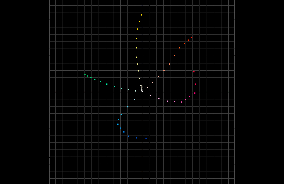

In short, color doesn't simply move in a straight line from paper white to solid. There are hue shifts and changes in L* and a changing contribution of the paper white to the perceived color; and that's with a single ink. Most folks haven't gathered enough data to be able to accurately predict what will happen to a spot color thoughout the tone scale. Without measuring these characteristics, we're just guessing.
Take a look at the attached screen grab. These are the primaries from a hex profile I got hold of. Notice the non-linearity going from paper to solid.
One thing that I suggest is that draw-downs be made for the whole tonal range. Shouldn't be tough to do with say a little-Joe press and a flexo blanket.
When building ICC profiles, A LOT of combinations of screens are printed and measured. To accurately proof blends of spot colors, these blends would need to be printed and measured.

Hi Rich,
"One thing that I suggest is that draw-downs be made for the whole tonal range. Shouldn't be tough to do with say a little-Joe press and a flexo blanket."
Is "draw-downs" really the term you intended here? How would that method lend itself to evaluating "the whole tonal range?"
Al
Hey, Al. I suppose that one could take issue with the term "draw-down", but I'm not sure what other term to use. I guess you're thinking of draw-downs being done with an ink-knife, but that's not the only way to do 'em.
My idea is to have something like a little-Joe and have a step wedge on the inking surface. I've seen examples where companies have their logo reversed out of the draw-down, so I think it's gotta' be possible.
Hi Rich,
You are right that I was thinking of the ink knife method. I have since spoken with the pressman here and he explained that the term is also used for the method you describe. I learned something.
Thanks,
Al
