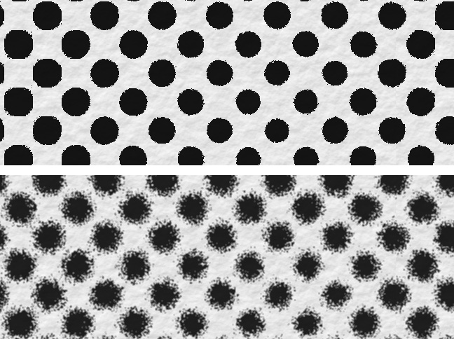

distorted dot.jpgI guess you can check the solids to see if they are emulsified. A check of your dot gains will also tell you if they are printing mushy ink. If you sign off on a press sheet that is not in balance then the press operator will most likely have excess colour variation during the press run. You must establish what your operating window is with your set of inks,paper,plates and fountain solution and adjust your pre-press files to be able to print the same way every day as long as the press is printing the same way everyday. A word of caution, you cannot establish an optimum print curve if your process is out of control, by this I mean fountain solution mixed correctly and clean, Inking rollers in good condition and set correctly, Plates and blankets packed correctly, Plates processed properly and verified against a standard.

As far as a quick press check - Run your finger over the wet ink. You'll quickly learn how much pressure, not much, but some.
Evaluate how much smear you achieve. About ninety seconds off the press with a coated sheet, I don't want to see the ink smear. Uncoated will not set up as fast, but there should never be much smear immediately pulled from the press in any condition.
Look at some type through a loupe - There should not be tails running, the type should be crisp and clean.

As mentioned earlier, tailing is a decent indicator of running too much ink as well as looking at your dots. There are other variables that can cause an ink to print fat or tail, so keep that in mind.
