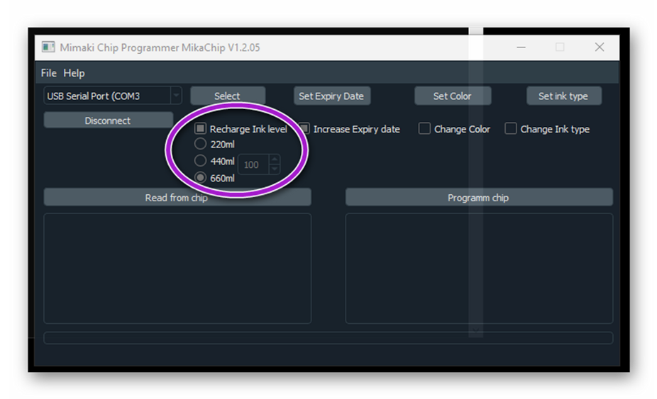

Let’s start with one of the most common parameters that users need to set up, topping up the ink level. In the MikaChip software, you need to tick off the ‘Recharge Ink Level’ box and select your cartridge vol. Then, you can set the ink level to the desired amount of 50%, 70% or 100%.

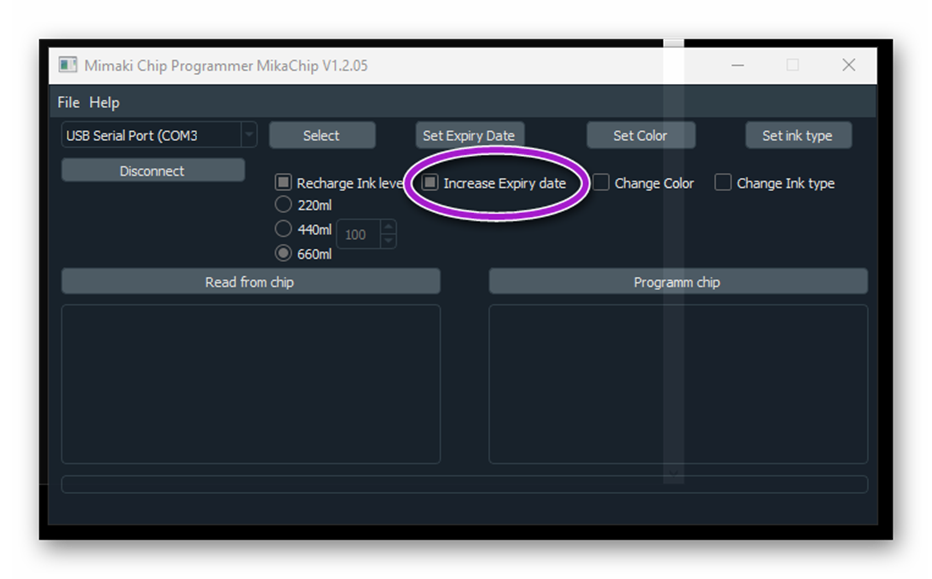

The expiry date is another common parameter that users need to reset. To change the expiry date of an ink chip, tick the ‘Increase Expiry Date’ box. This automatically extends the expiry date of the ink chips for 3-6 months.

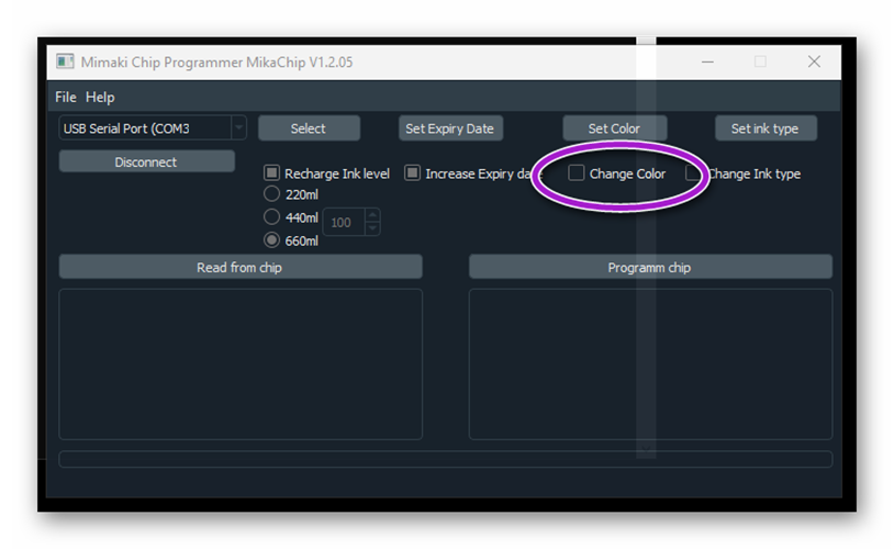

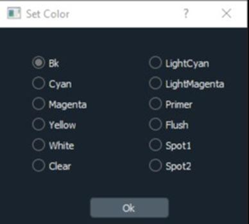

If you need to change the color on the ink chip, you need to tick the ‘Change Color’ box. Ticking this box gives you a menu for selecting the color you want. Simply select the color you need from the menu, and then the software will automatically write the new color onto the chip.
Here is the list of colors in the Set Color submenu:

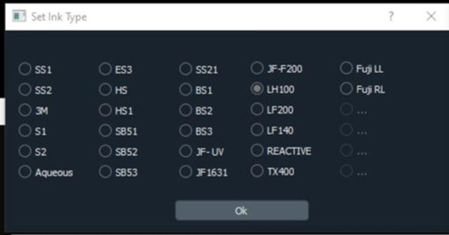

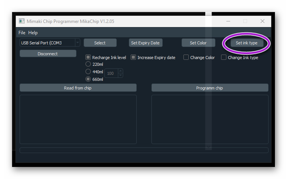

If you need to change the ink type, tick the ‘Change Ink Type’ box. After ticking the box, a list of ink types available will open allowing you to select the type of ink that best suits your needs.
Here are the ink types available in the submenu item:

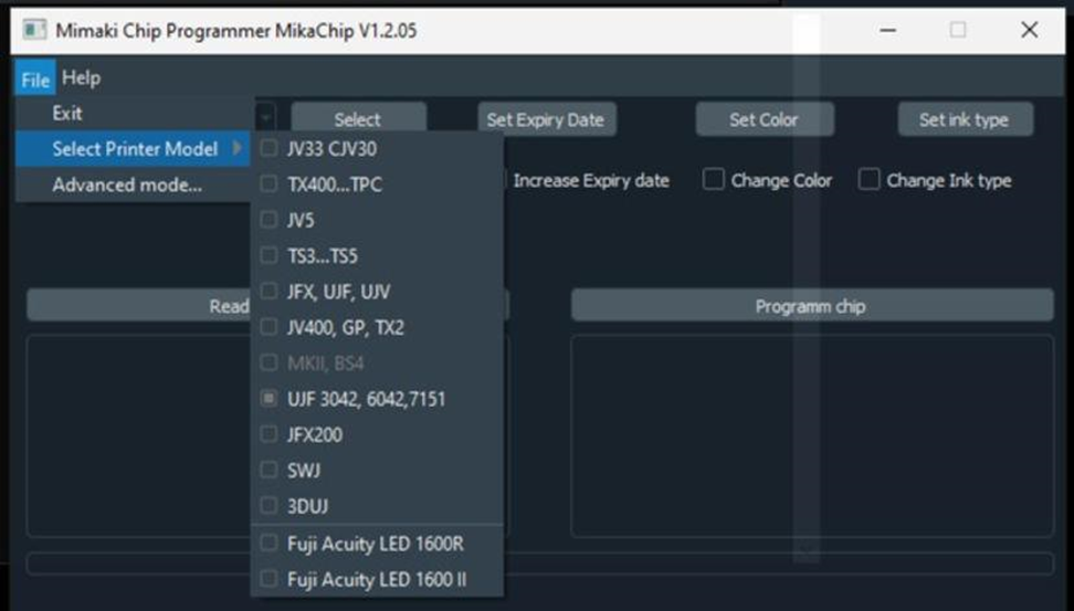

Now let’s see which printer models the MikaChip resetter supports. To find the list of printer models, select open “File” then “Select Printer Model.” This opens a drop-down menu with a complete list of models supported by Mikachip. The supported models include the JV33, CJV30, JV5, TX400, TS3, JFX, UJF, UJV, SWJ, Fuji Acuity LED 1600R, Fuji Acuity LED 1600 II and more.

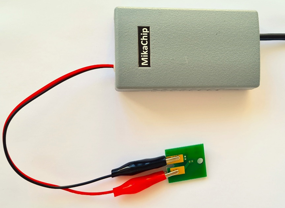

Once you set up all of the parameters in the software, you use the physical device to reprogram the chips. The device includes a USB cable to connect to your computer.
After connecting the device to your computer, connect the ink chip to the device by attaching the black ‘alligator connector’ to the long plate, and the red ‘alligator connector’ to the short plate on the ink chip.

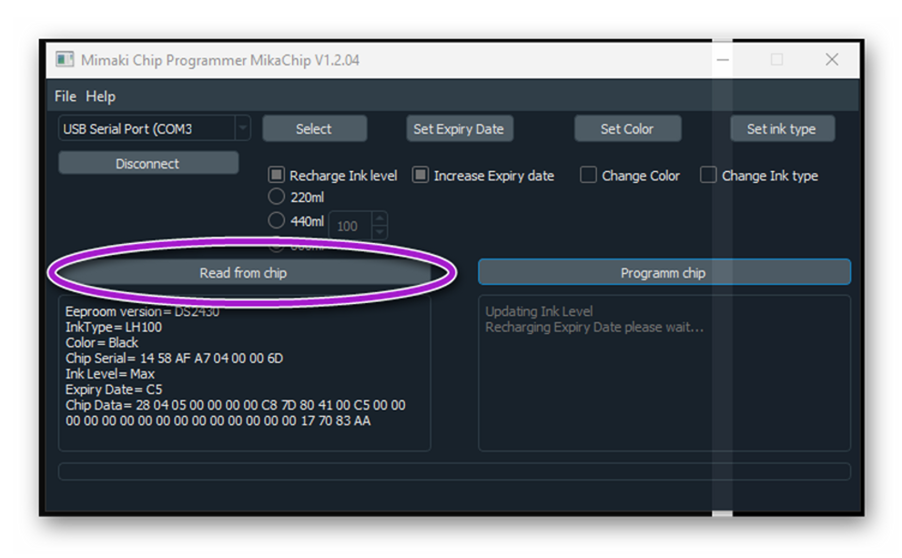

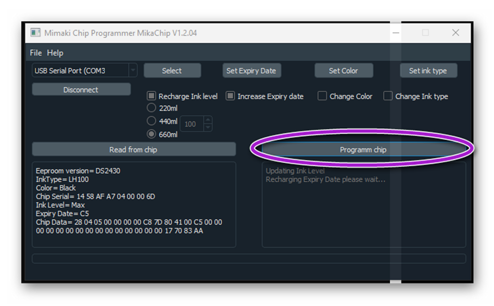

With your chip connected to your computer, click on the “Read from chip” button in the software to get the necessary information from your chip.
Finally, you can program the chip with the parameters you previously set. Click the “Program chip” button and the software will write all the selected parameters onto the chip.
If the parameters write successfully, the software gives you a “Success” notification. After receiving the notification you can disconnect your ink chip and use it as usual. You can also follow these steps again to reprogram your ink chips as often as you need.
