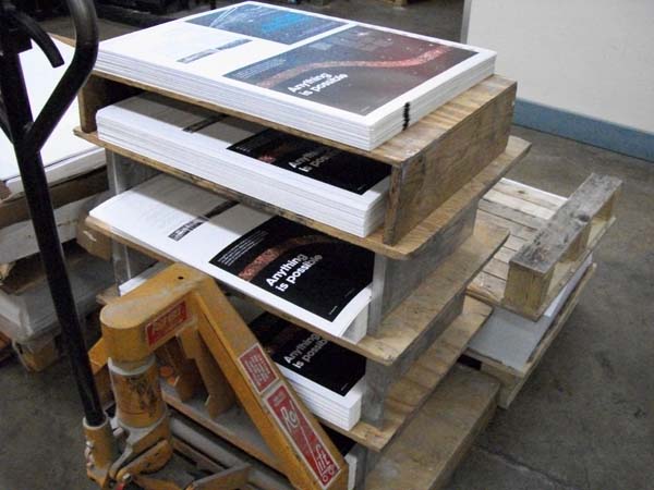

Its not so bad as you think . . . build some "L" bars from 1x4 stock or similar we have both aluminum and wooden ones and get extra press boards and just put a new press board in on the racks like in the photo below.
