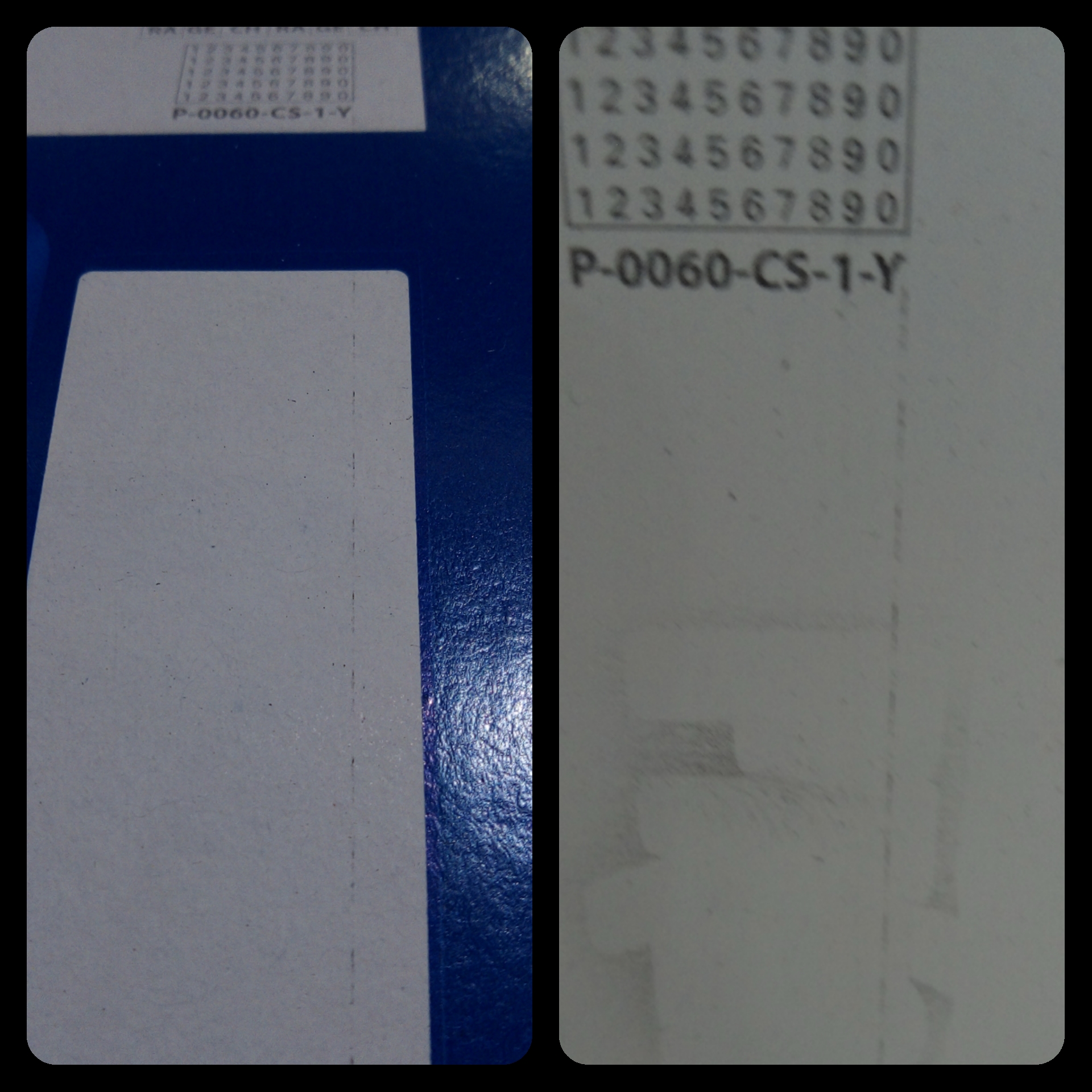

Thin lines appearing on plates

Follow up:
After a little over a month since we stopped marking the plates directly with a knife we have had just one reported case of lines. You can see it coincides with the numbers where we used to mark the production order number. Didn't get a chance to check the roller surface for any debries. So it seems the markings were causing the lines. Thanks everybody for your comments!
I have seen Komori's plate hangers scratch plates. The Bar that supports the tail end of plate while staging plate to be hung will create a straight line if bar is dirty or rubber wheels are worn.
If Fuji LP plates are going through processor, catch it and process 90 degrees to see if line direction changes.
