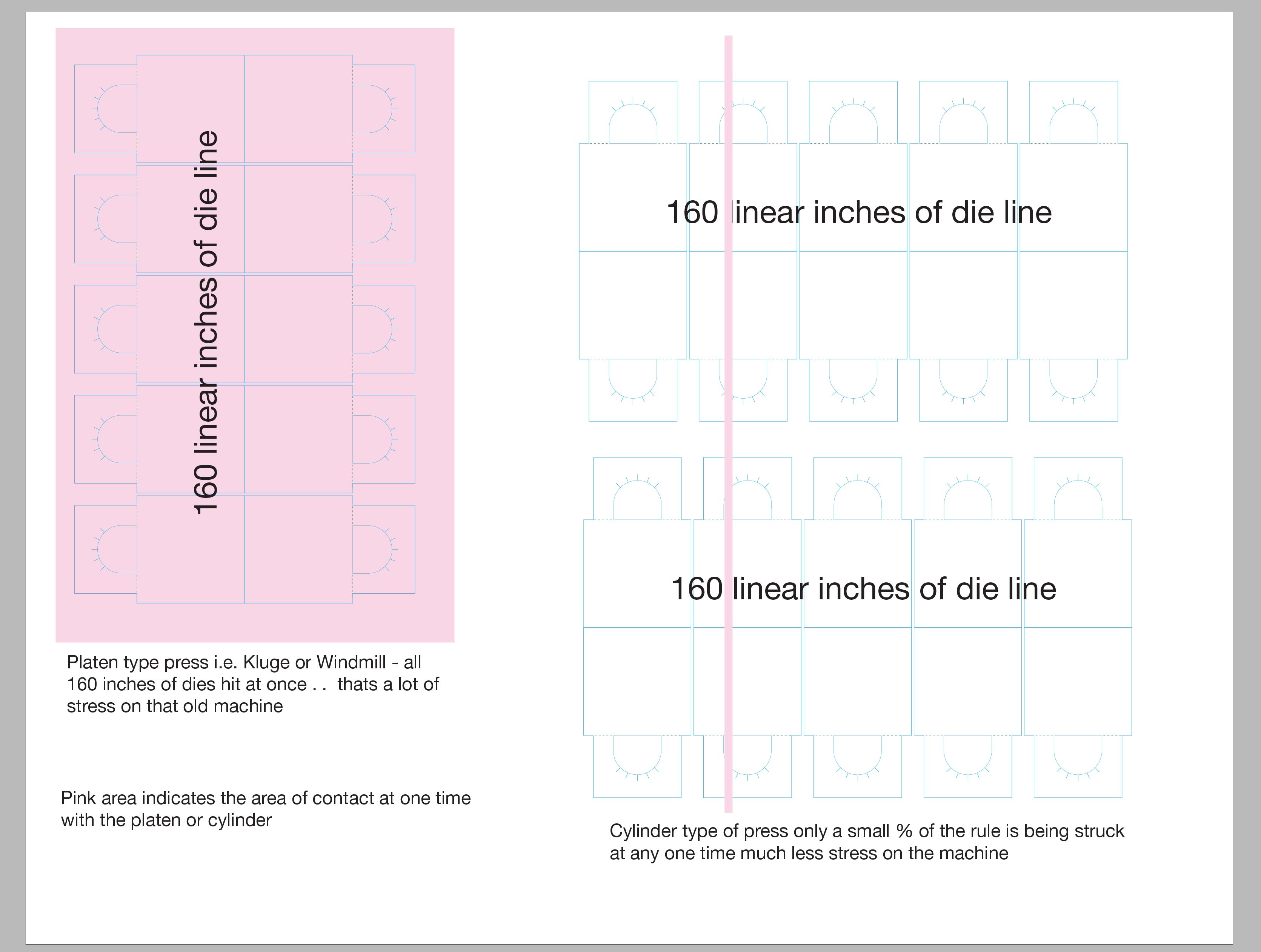

A word of warning on the platen presses . . . they are more versatile as far as being able to foil, emboss, score, and die cut but you are severely limited by the amount of die inches you can cut at once - you have to remember that you are hitting all of the die at once so if you have a very involved die lots of cutting/creasing rules you might have as much as 200 inches of rule all hitting at the same time where on a cylinder you are only hitting the rules that the cylinder hits as its going across. On our cylinder press converting it to foil/emboss would be quite an expensive endeavor so we have a Kluge that we do our foiling/embossing on.
In the past we only had a Kluge 12x18 that we used for die cutting and when running bottle hangers we actually shattered one of the platen adjustment bolts from the repeated impacts - had to have one custom machined since Kluge won't sell parts for a press that old. Went to the cylinder and never looked back . . . see images about die rule inches attached
So depending on what your demands are there are several solutions . . . if you just need to emboss/foil Letterheads, Envelopes, Bus. Cards and some die cutting platens will work great. for larger die cutting like Presentation Folders and multi up die cutting forms you would be better off with a cylinder press, but if money or space isn't an issue go for the boost and a platen for the small stuff. :)
