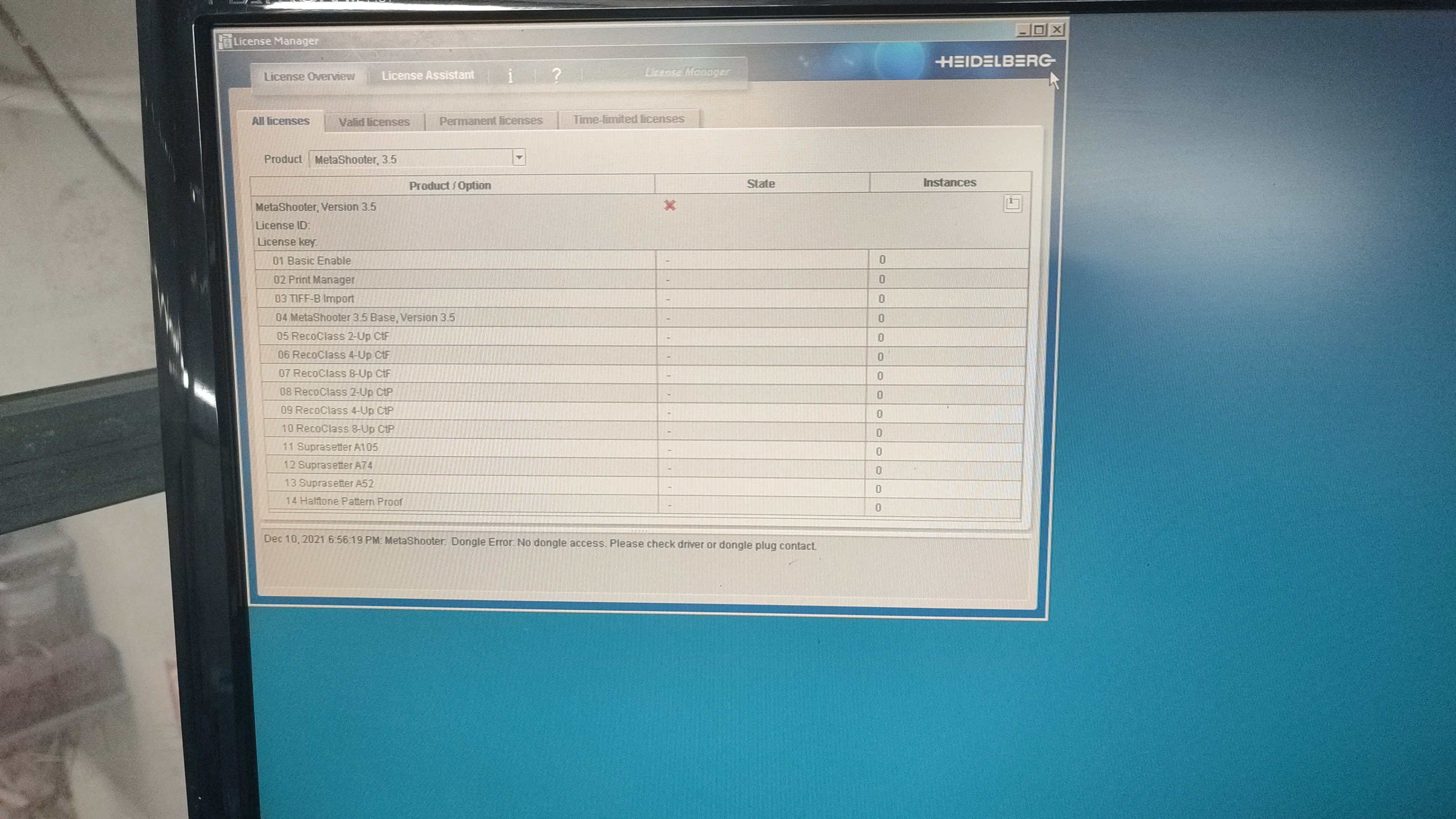

Need some urgent help. I tried to install a harlequin rip we have for a DI press that comes with its usb dongle and is seems to have overwritten the dongle for the meta console manager for the topsetter.
When i open the meta console manager it says no dongle found. Under licenses no dongle found also.
What can I do?
maxon
Dongles are fine you just ended up replacing a working dongle driver with another version of driver. Uninstall the harlequin then reinstall the sentinel driver for the shooter (look for dongle driver setup inside the Heidelberg setup package). Or revert/roll-back driver if possible from Windows device manager.

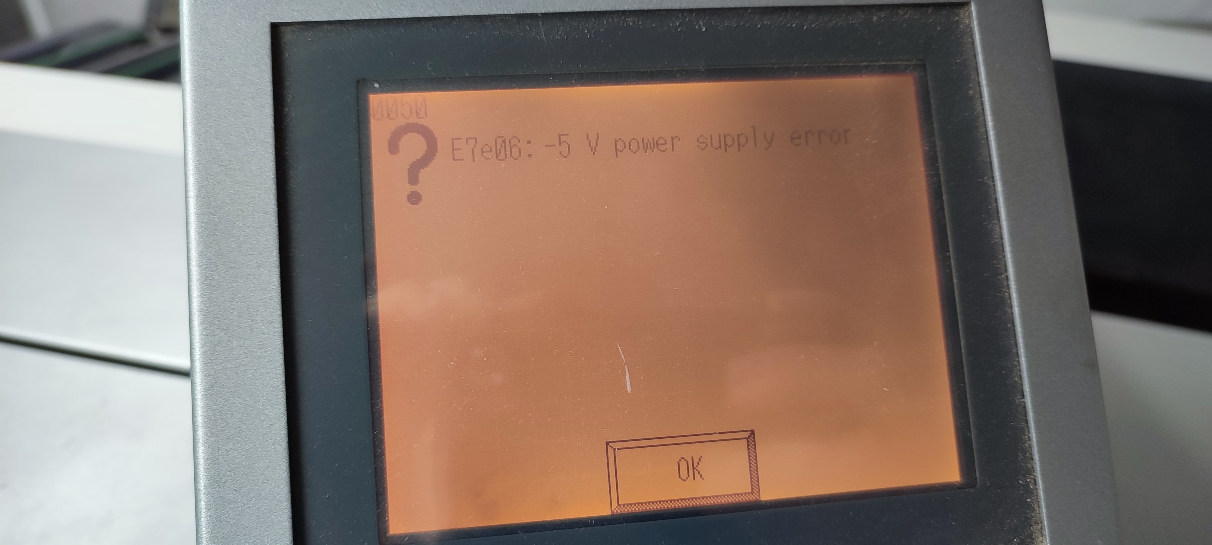

Have now another problem. Maybe you could help. When trying to image.
E7e06 -5v power supply error

chock
Hi , if have problem of power supply Vdc - 5 Vdc, please replace it.,and measure input voltage for VCA, if there are in tolerance 10% up or down, otherwise, adjust the Primary tap of main transformer of machine.
However you must review the Input machine, if the Input Voltage is Stable, if NOT, i strong recommend you to install Regulator Voltage special, for to avoid further damage in the future in another sections of machine.

Hi maxxon, Its a topsetter 74, not sure the year. We are using a meta shooter if thats what you mean by config.
I searched online, other with same problem suggested the increase the voltage on the 5v psu. I raised to 5.43v. and seemed to have fixed the problem , but need to keep testing.
Chock, yes i will check our voltage . Thanks
