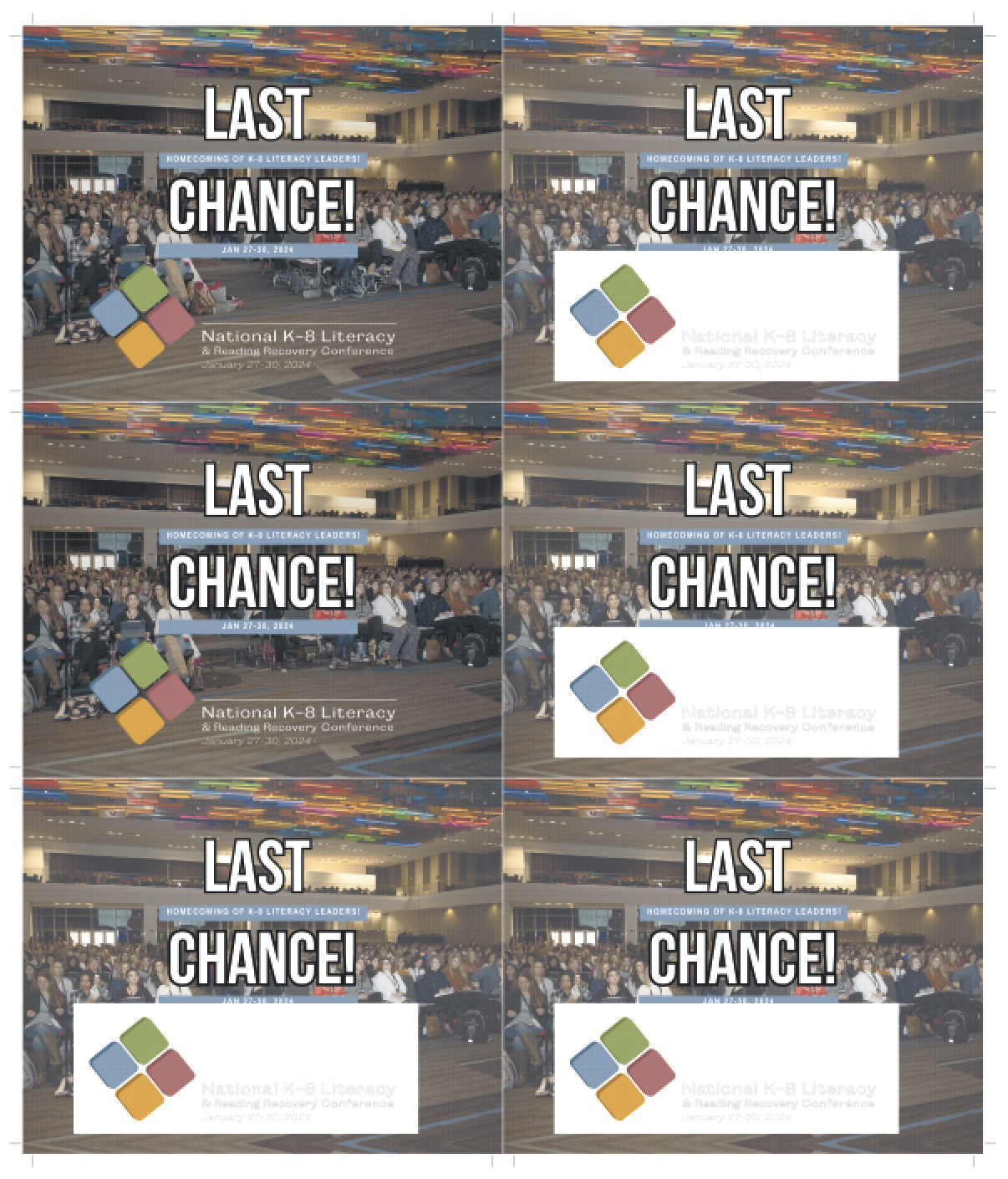

I thought I would ask because I had a similar issue several months ago with a PDF file created by Canva. Although the project was digitally printed using a Heidelberg rip, I thought I would try rendering it with my Apogee system and this is what I got. As you can see, it rendered two out of the 6 positions correctly. Just to be clear, this was a single PDF containing a 6-up imposition of the same art.
To get the file to render correctly, I had to flatten it.

I did flatten the file and it ripped fine. Later I tried ripping with trapping off at Fuji's recommendation which also worked fine.
Interesting. When I first rendered the aforementioned Canva file, I was on Apogee v12. Now, I am on v13.5 and the Canva file renders all 6 positions correctly.
This is still a problem with XMF. I was told by Fuji they still have a ticket in with Adobe but it deals with trapping through XMF. So you can turn trapping off...or tiff the problem areas and reload a pdf in.
