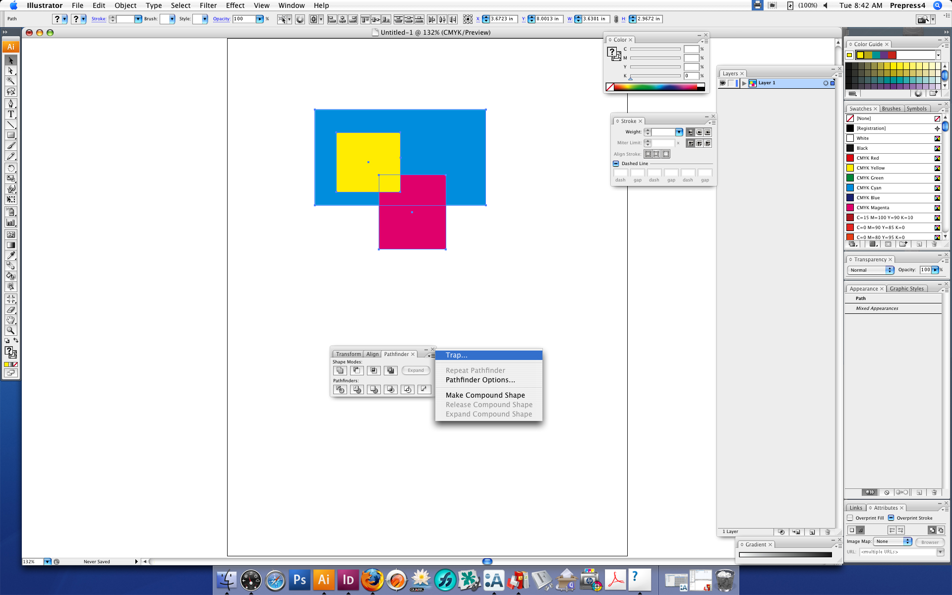

Illustrator has a trapping option. I've never used it, but assume it would work o.k. (although I just did a test and it will only trap between solids and flat screen tints. It would not trap to a CT image or a vignett) Open up your pathfinder pallette, select "trap" and set your parameters.
see attached.
