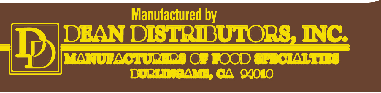

When we do the trap feature, it traps the outside trap correct. But it also does like a reverse trap on the inside of the letters, like an O. The letters are yellow, the rest is dark brown. The yellow goes out, like we want. The brown on the inside goes out as well into the yellow some places. Please help?
This is BluntBrad's artist.
Basically, I have some text that has been converted to outlines. The letters with 'cutouts' in them, like an 'A', a lowercase 'e', a 'D', etc - are compound shapes.
When I go to trap these shapes with the background, the outside of the shapes are trapped correctly. The inside, 'negative' space of the shapes are creating a reverse trap.
See image:
In Illustrator:
This happens whether I use the pathfinder popout window, or effect>pathfinder>trap
Trying to trap at .75 points with a 100% thickness and no tint reduction (100%).
I cannot recreate the issue. I am in CS6 and no matter what shape I trap (compound, non compound, text) it always traps correctly. Maybe try adding an overprinting stroke instead of trapping.

cs6 illy files can be buggy. have you tried creating a whole new document and then placing your letters/artwork into the new document then try your trapping. and while youre in illy if trap is not working to get the job done then can't a trap easily be faked?

wow what a mess. seems like you'd be able to use your direct select tool and get rid of everything you don't need. there may even be clipping masks you need to release, same thing with compound paths.

This is a pdf of the illustrator file I'm working with.
Trying to trap the brown/yellow at the bottom.

I have attached a PDF screen shot of your letters trapped. I may be missing something, but it appears that a simple stroke set to overprint would solve this problem.
My screen shot shows your art in overprint view with the settings I used to make this trap.
If this is the trap you are seeking, please notice the setting for rounded corners. If left as square corners, they were some strange spikes in the yellow trap. These tend to show up more when type is turned to outlines as opposed.
As a sidebar, when I looked at the rest of your art in overprint mode, the white line separating the yellow from the brown in the bottom part of the figure disappears. Did you mean for this to be this way?

Seems like the file is corrupt. Using the trap filter, I get the same results that you do on the document you posted. If I copy everything over to a new document, the trap filter works with the exception of the DD in the upper left. There's one D in that logo that has to be expanded to get the filter to work.
Overprinting strokes works on the original document.
Just for giggles, copy everything over to a new document and try the trap function.
