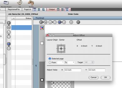

Hello. we have Trueflow SE 7. Does ver.6.01 have the ability to move individual page position under the
Pagelist or Output tabs? If it does can't you manually set your creep with this? You would be able to enter
your coordinates in the appropriate fields.

hi,
where is this pagelist ?? in TrueFlow ? or FlatWorker ?? Could you give me screenshoot ! Please!!! Please!!!

Ok this is the first time I’ve tried uploading an attachment. If you click on a page
you will see some icons under Thumbnails. The icon on the right ( the one that looks like a register mark)is the one you want to click. It will open the Adjust Offset tab where you will enter your adustments.

Thanks for this screenshot!
I guess it is a tab "Jobs" - We do not use it. :)
It seems to me that your way of calculation of creep forces individually for each page.
I'm looking for a way to be able to enter creep in such a way to be able to do it in one place.
