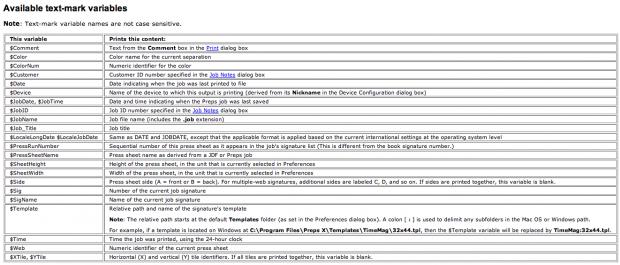

Your screen captures did not come through but based on your questions I can't help but wonder why you are going through all this. Why not just use the predefined Preps text variables in your template so the job, sig, side, color etc are automatically generated on output? I have attached a screen capture for you reference. Hope this helps.

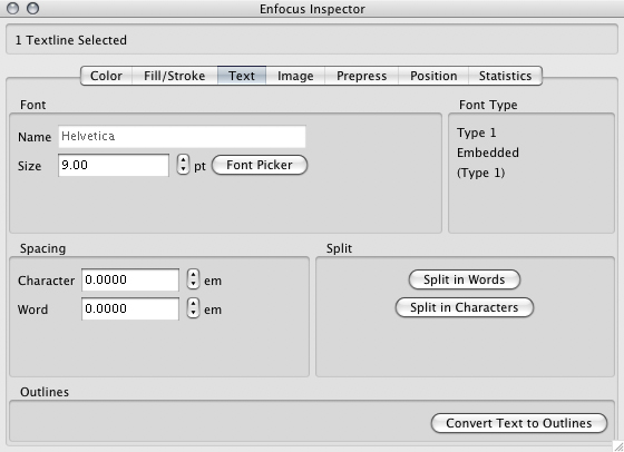

I assume "linked together" means that multiple text areas that you would like to edit discretely are encoded as a single line. If that is the case, you can use the "split into characters" button in the inspector window to break them up first. If they are close enough to each other, Pitstop will still move text to the right of the segment you are editing. You can prevent it from doing that by first moving text segments up or down by a small amount, exceeding the threshold Pitstop uses to determine if the text should be treated as one line or not. I think .001 inch is enough. The text can be harder to select when split into characters if there is anything behind it - you can hold down alt/option when selecting with the Pitstop selection tool to only select objects that are completely contained within the marquee area.
This is correct. I wonder if you move the line of text up or down w/o splitting into characters would work...will try

I was not able to repeat the problem. With neither Helvetica nor Arial loaded, I was able to edit the text and add characters without any errors. The "Enfocus Inspector" window in your screen-shot appears different from mine, which probably means you have a different Pitstop version. Attached is a screen-shot of my window.
I used Pitstop 7.52 in Acrobat 7.1.0 & OS 10.5.4 Intel. You can download 7.52 from this page:
Enfocus - Where can I download the installers for older versions of Enfocus Products.
If you're using Pitstop 6, you can also download 6.53 from the same page, which was the latest subversion.
