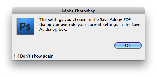

When you try to save as Photoshop PDF, do you get to that dialog box that states;
"The setting you choose..." ( i uploaded and added a screen capture of the dialog box - see below )
--- or does it error immediately ?
Did you recently update Acrobat ( I seem to recall that the engine that Photoshop uses is tied to Acrobat, not sure of that ... ) I assume this is just happening on one ( 1 ) computer, yes ?
