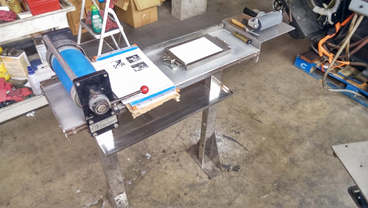

2. Yes, offset. The ink drawdown is done on a hand cranked mini offset press called a "Little Joe".
It is a dry offset press (no fountain solution). It is typically used by offset printers and/or ink suppliers to show what an ink color mix or varnish looks like on a customer's paper choice - in your case the brown kraft.
