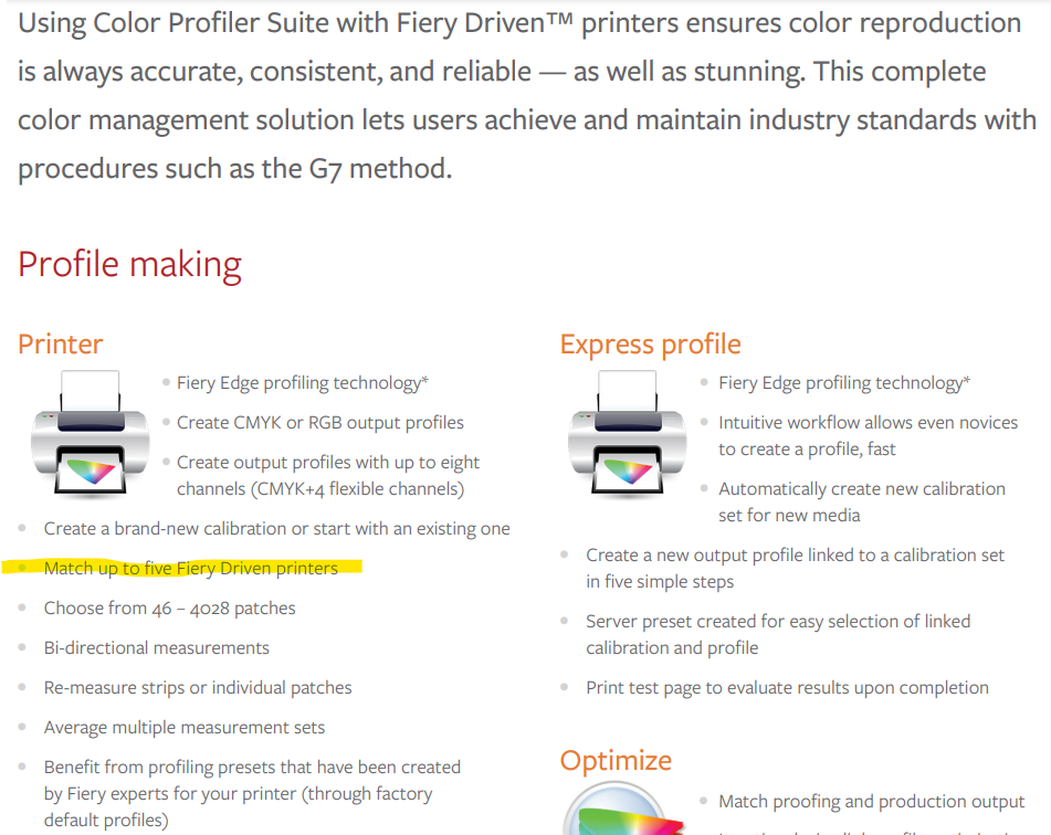

We had an expert come in and try to tell me that it was a lighting problem. Which... made no sense because if I turned off the fiery color management then my gray's printed gray and if I turned it on it printed pink (and you can look at both under the exact same lighting).
Anyways, nearly 6 months of back and forth with them on this, Fiery finally sent in an "expert" who used a G7 profiling device, created a single profile calibrated to our exact machine and now problem appears to have been resolved.
We have a single profile for all the stocks that we can now calibrate against when needed (instead of multiple). The colors appear to be holding on both our v1000 and the c810 (we will see how long that lasts.
