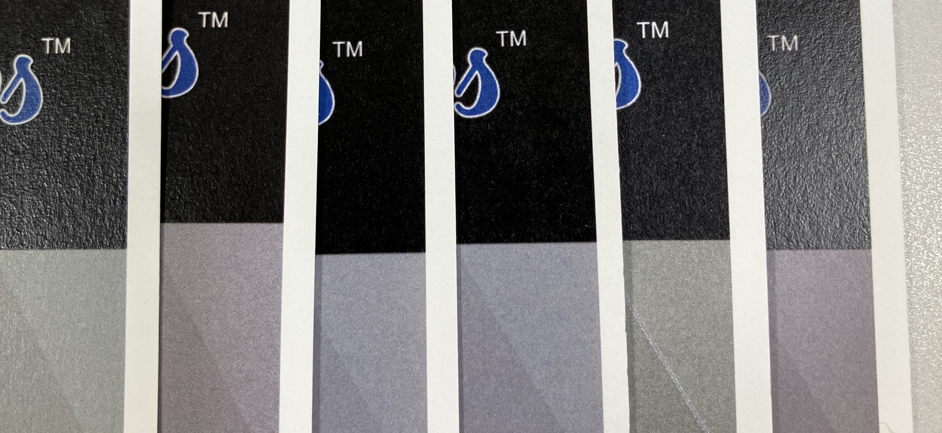

We aren't expecting miracles but when I color calibrate our Canon printers (we have four Canons) I get wildly different results depending on the steps I take. The photo below were all printed on the same printer, same paper, same file but after taking slightly different calibration steps using the Fiery Calibrate tool in Fiery with an EFI X-Rite i1Pro3 color calibrator.
The question is... which color is the right color and how would you know and verify that?
