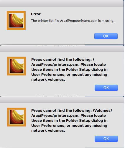

This may be a lame question but can someone tell me where to find the User Preferences in 8.3? I've been trying to get my Preps to work again but not having a lot of luck. These are the messages I'm getting in this order. This all started after we changed the router and had to assign new IP addresses. Thank you!

Start Preps, go to Edit/Preferences/Folders and set the correct path
If Preps wont start at all, you may need to edit the folder paths in \\CreoAraxi\AraxiPreps\Profiles\PrepsPrinergy\PrepsPrinergy.cfg
That's assuming you are using the PrepsPrinergy Config file

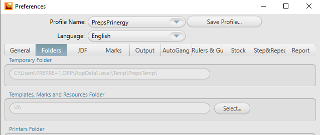

Where did you find that window or does that only come up when you have Preps open?
That's the preferences window in Preps, so Preps needs to be open first.
The folder locations should not prevent you from opening Preps, but if they are, you need to edit the config file
