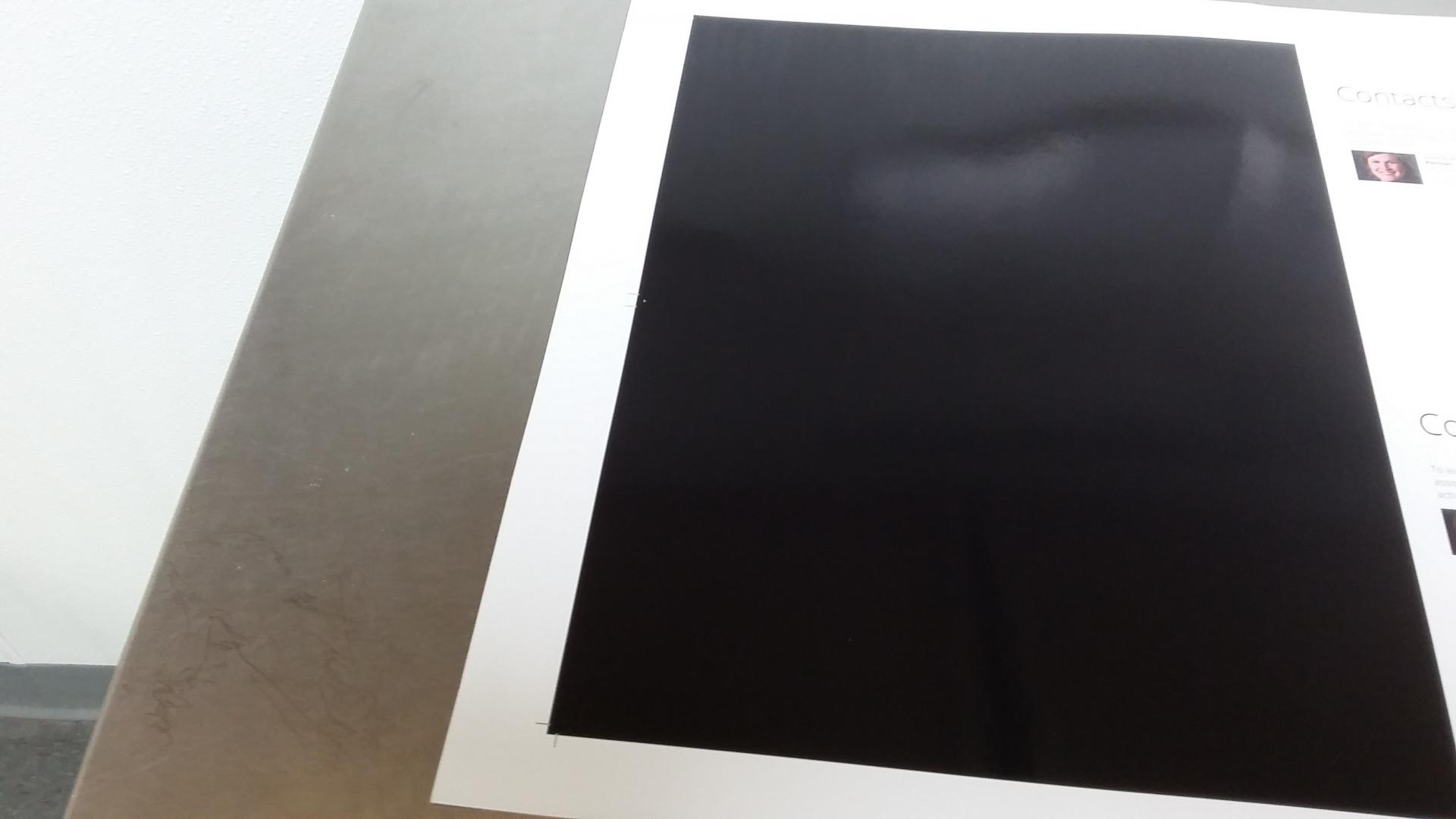

Think I found a solution for this problem. I've been using Actega chemistry with my Morgana Digi-Coater, the gloss I was using was DUV-9021A. Worked fine with my Indigo inks but terrible with my ProC9100 toner. Got some new stuff from Actega, this one is DUV-9058DG and as you can see in the attached pic, even on that massive coverage, it worked great! I can dig my fingernail into it and dent the paper with not even a scratch in the coating. Also fracturing is next to none when trimming. The only drawback is that I normally run my coater at a speed of 60, and at that speed this stuff still scratches off pretty easy. Backed the speed down to 40 and this stuff worked great. Hopefully this will be of help.

That's awesome tpmar! Glad you found a solution that works for you. So speed does come into play on ours as well. Gloss UV we run fairly fast but if we run Satin UV we have to slow it way down. The type of stock has an effect as well. The stock of choice for book covers and bc is Tango. It seems to coat well and set hassle free.
