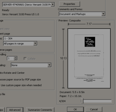

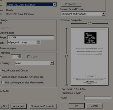

Question pertaining to a Xerox Versant 3100 in relation to mixed media printing - specifically to 5.5x8.5" stock. Short end of it - I cannot get to this to work correctly. I own a 700i (w/ Fiery) as well - when printing from a .pdf - I can select "choose paper source by .pdf size" - the 700 has the 5.5.x8.5" loaded - and set on the machine tray settings (after closing tray door) - hit print - call it a day.
The 3100 - when selecting paper source by .pdf size - the print preview image will not adjust to 8.5x5.5" it recognizes the 'document' is 5.5x8.5" however, the 'paper' goes from 8.5x11" to 10.13x7.2" (vs 5.5x8.5" screen shots included for both). (Stock Library Manager has the trays matching 5.5x8.5").
The screen shots provided are from the same pdf, just selecting the 700 and 3100.
I've tried the three drivers EFI has available 1.0, 1.1 and 1.2.
