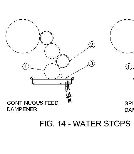

we used to build a water stop out of soft rubber, some times we used the fatigue mats. but up against the fountain roller to back off the water out side the sheet size. saw the pic online maybe someone sells them.

First off, I would like to thank everyone for there responses. It is very nice to see people helping out other people in the trade. Because I also run evelopes, it is impossibe to put take off bars on to help keep the water away. So what I did is go thru all the rollers in the magenta unit (as retired heidelberg instructor mentioned) very carefully as that is the unit giving me the most grief. Roller settings weren't to bad except for the ink ductor to the ink fountain roller. All units were only about 2mm instead of the require 4mm. Once that was done and some very minor tweaking on all the other rollers, I started to run the press and magenta toned in like crazy. As it turned out, because of the water problem, I was squeezing the pan roller more than I had to and increasing the dwell on the pan roller. So then I reset the pan roller to specs, dropped the water down about 20% and now runs fantastic. Repeated this on other 4 units, ran a 5 color job and all was very well.
Since I am able to run the water so much lower to keep the print clean, I am pretty sure that not as much water will be introduced to the non-image area allowing me to run narrow sheets without washing out. Time will tell.
