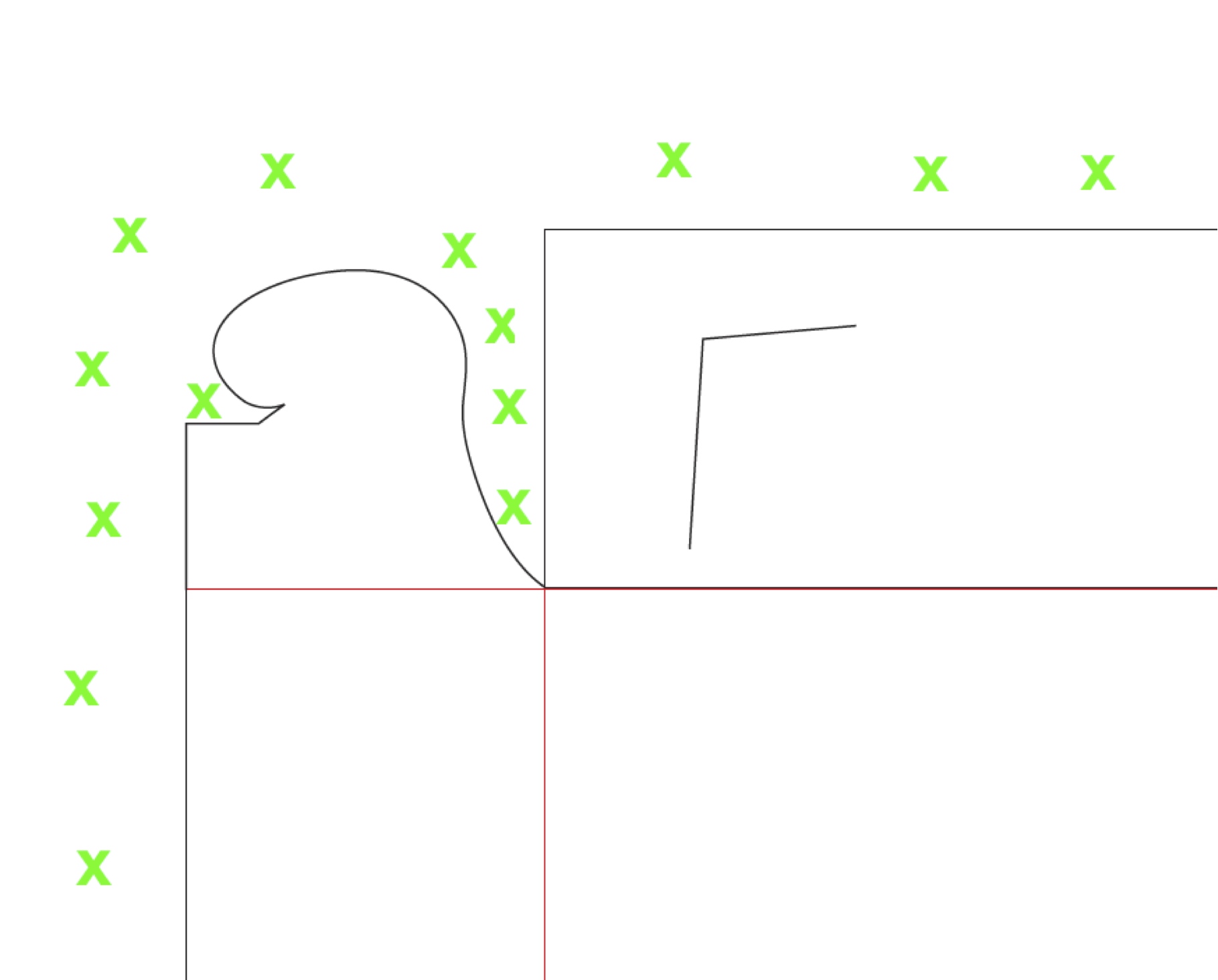

The one that tripped me up most recently was 2M "donut boxes" on 20pt board with some intricate insertion tabs. (See attached sample corner, 2.5" tall on the box edge).
Stripping the waste took "forever" (i.e., 3 hours): they could burst only about 1/4" of material at a time due to the long "tongue".

For exterior you can use waste stripper from BOBST or some Chinese manufacturers also produce waste strippers. Saves a lot of time.
For interior you can do it on die cutters.
I've seen places that used air chisels to help the removal of the exterior pieces . .. they would go through a 3 foot high stack in a very short time . . for interior removal we make a board with the appropriate "holes" to make it easy to punch them through and the pressman does it as they come off the press, about 20 - 30 sheets at a time
