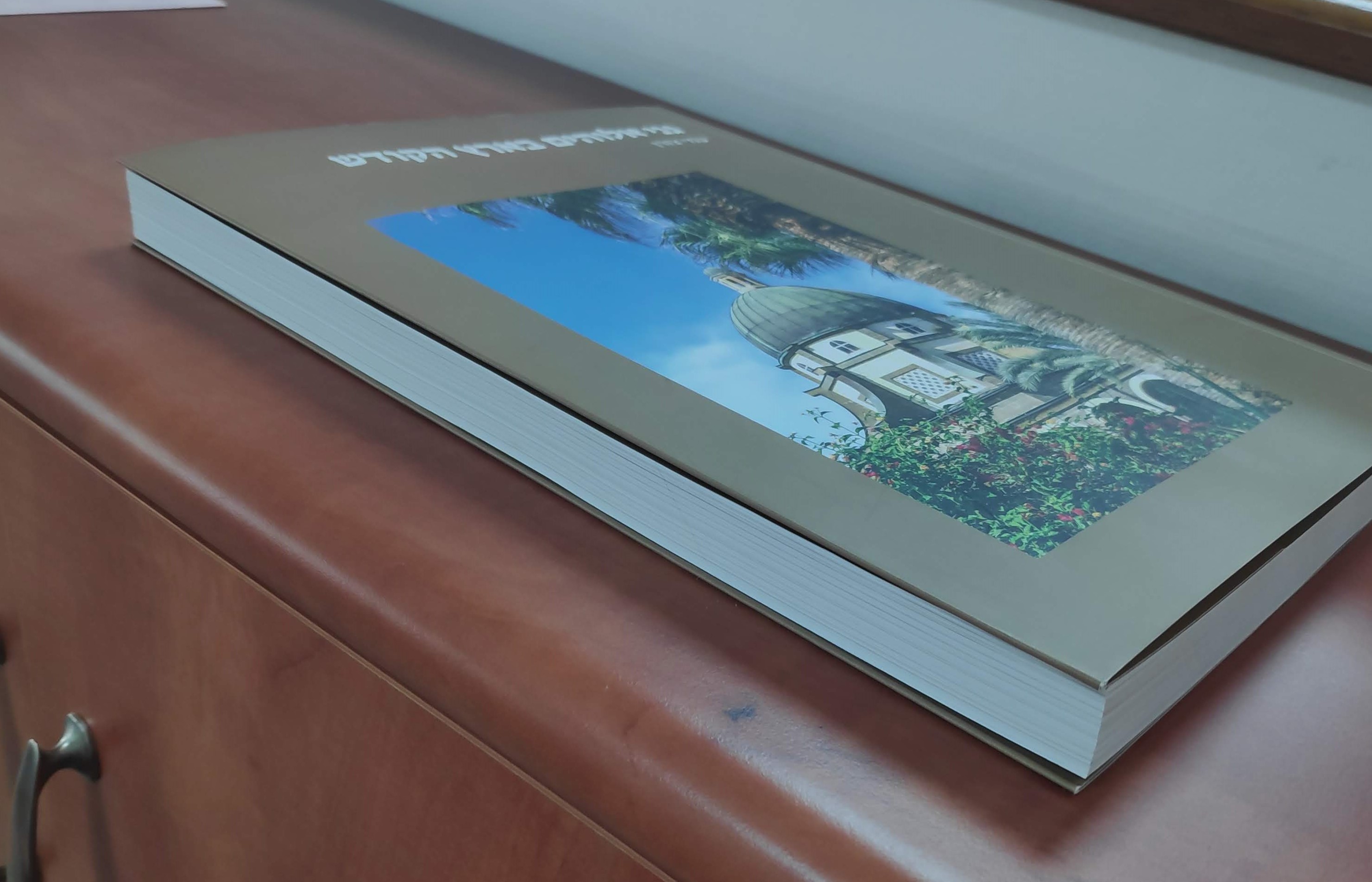

Thank you all dear friends.
I'm back after difficult period we've experienced here in Israel (Hi Carlos) due to the Corona virus including lock-downs etc.
I was really impressed of the wide spectrum of ideas and solutions you suggested.
To those who asked, I repeat, the book was printed on Indigo 7200, Roll to Sheet, so the grain direction is perpendicular to the spine.
I'm happy to tell you that the solution was found. I just left it in the open air in a room temperature and it got straightened after 2 weeks. Have a look:
I believe it will help everybody in cases like that.
