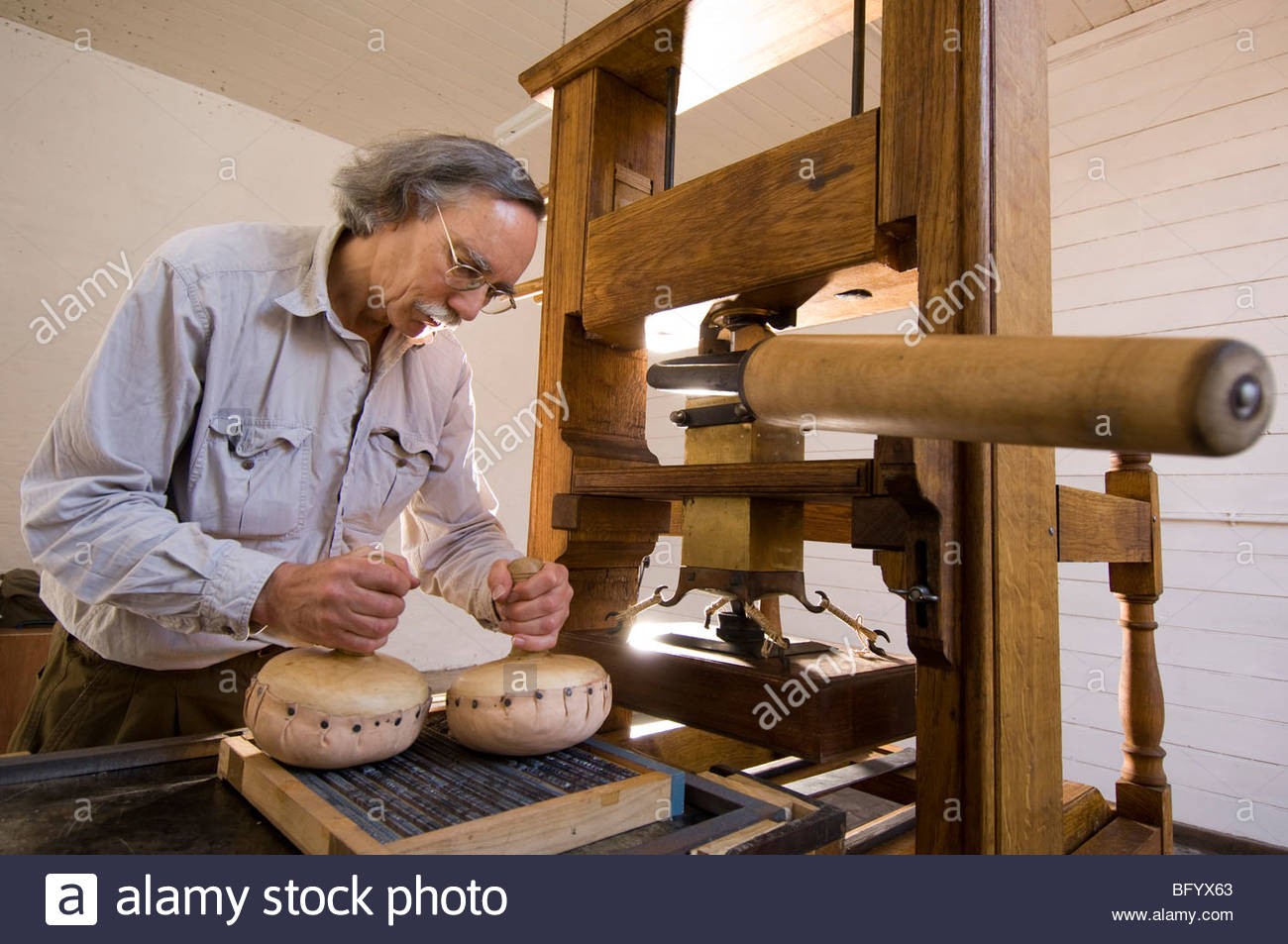

I believe the term Ink ball has been used in the past to describe the ink fountain roller. The term is about 600 years old and refers to the leather Ball used to apply ink to the raised type in Letterpress printing.
CP, I thoght was called a dabber? We'll let Erik dabble into this one.

This is getting to be fun to see all the twisted terms in use. When I was involved with Dry Offset (not Waterless Offset), they used the term dabber roller to describe the ductor roller. At the time, I thought that was strange but can now see how some terms has come from different historical printing origins.
