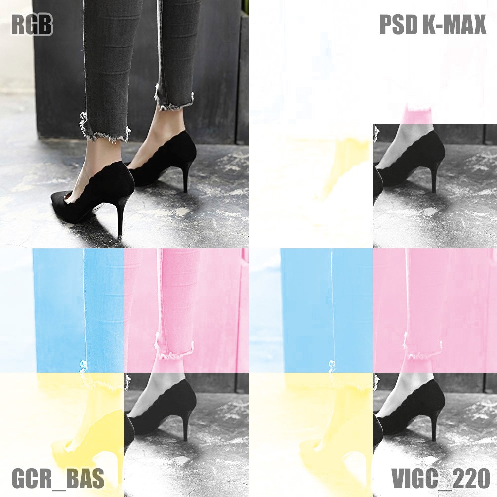

My printer colleague has tasted the sweet flavor of a photo with maximum black generation as you can do in Photoshop (see pic) and since then he always wants more.
Obviously if the Photoshop function was enough I would not be here asking.
The problem is it tends to change colors too much if they are far from neutral tones - I have been able to use it only on photographs with very little color areas so far, and only if client did not require particular color accuracy.
I found a couple of ICC profiles that are very interesting, but no one has a black generation so high - even though I was able to use one of them in many jobs with good results:

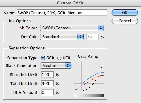

Click image for larger version  Name:	2BA96EE5-D3F9-4502-B31E-CC6BA941BA50.png Views:	1 Size:	79.6 KB ID:	279445

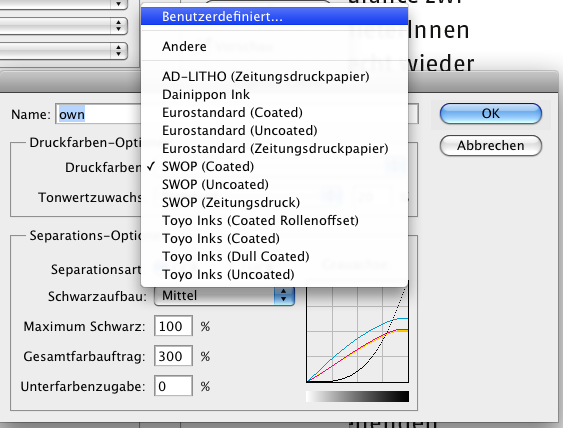

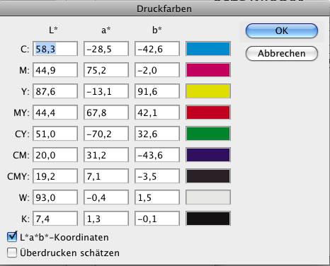

if you do not have a DLP-Tool like ALWAN cmyk-optimizer in which you can influence the GCR as you like, as in your Photoshop-Settings you had posted, it might help when you will set the LAB-values for solids and secondary colours from the FOGRA39 characterization-Data sets in Photoshop by „own “/User defined, or did you try it already?
(I guess not, because in your Screenshot ist SWOP to read...). Of course that would not be the same to create a Profile with only 9 stations compared with about 1400 and more in a real icc-profile, but may be it is worth one more try?
(Take care, the values above in my Screenshot are not the ones from FOGRA 39...)
On the basiccolor Site is also a Profile named ISO coated v2 sw, but that is better for use to change „coulored“, neutral Black into only k, when files in RGB come from Office-Software, so you will miss deep Black for your purpose.

The legacy custom CMYK max. K setting is good for comic book conversions and screenshots (perhaps with the trapping command) – but I would not use it for general photographic content.
The coated_FOGRA39_GCR_bas.icc is very good, it is just a little bit short of a “ink saving profile”… Why don’t you just work with that and see how it goes?

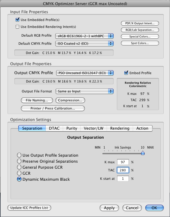

Click image for larger version  Name:	34CCF178-EF36-41F1-AC52-39FAF8BDF312.png Views:	1 Size:	109.4 KB ID:	279566

ALWANs CMYK-Optimizer allows you to create different DeviceLink-variations, for an example see attached screenshot
