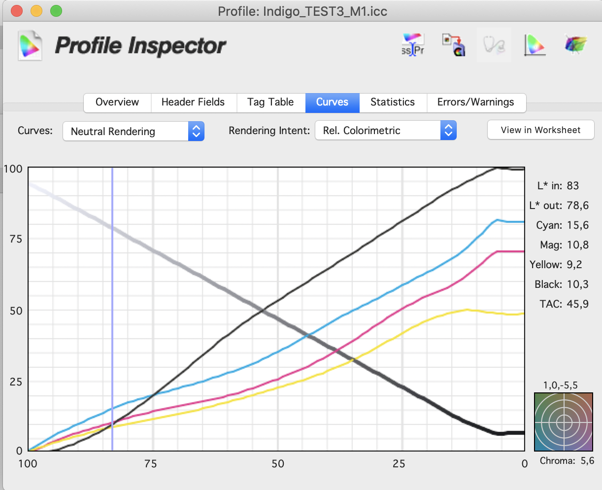

I'm making a CMYK icc-profile for our HP Indigo Press with X-rite i1Profiler (v 3.3.0) and i1Pro2 (IO-table). For production reasons (metamerism etc) I would like maximum GCR and black start at 0. But although I put all sliders to the max the final ICC-profile generates a lot of CMY in near neutral tones and very little black (relative col + bpc). Instead of the expected most black and just a little of CMY.

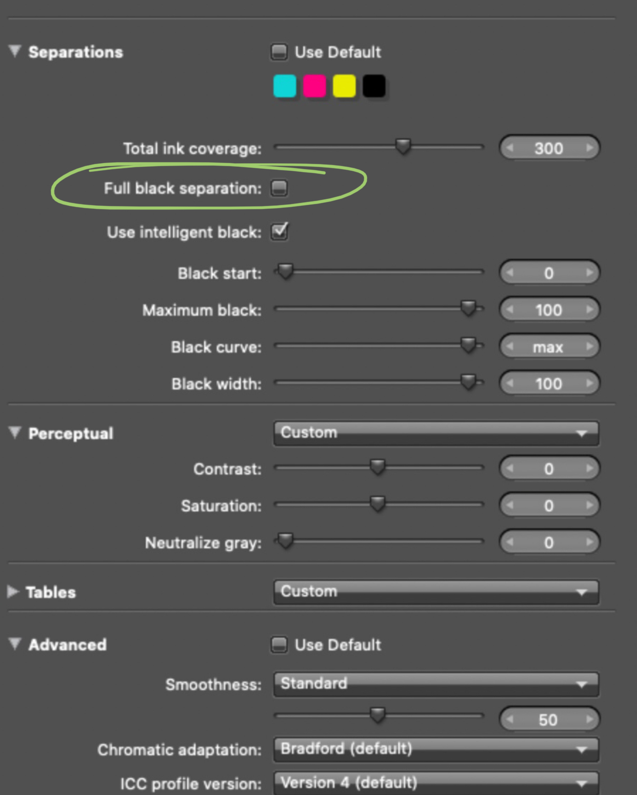

This is my Profile Settings in i1Profiler:
If I open the resulting profile in ColorThink Pro and look at the neutral rendering I can clearly see that there's a lot of CMY in the highlights:

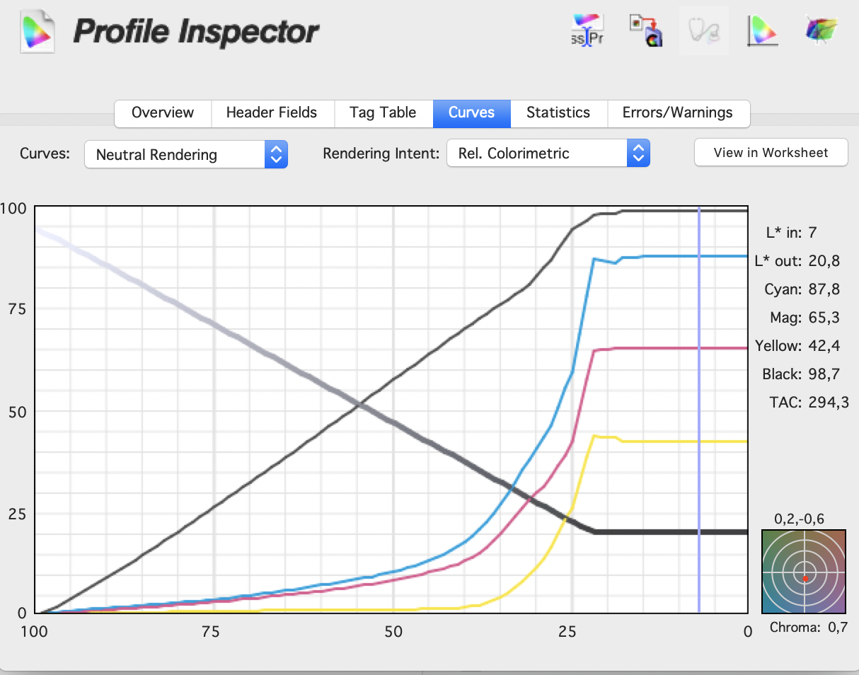

But 'm expecting something more like this (from another profile with a lot of GCR, made in another software):
I don't understand what I'm doing wrong? Could it be the measurement data that is causing this issue some how? Any advice would be appreciated!

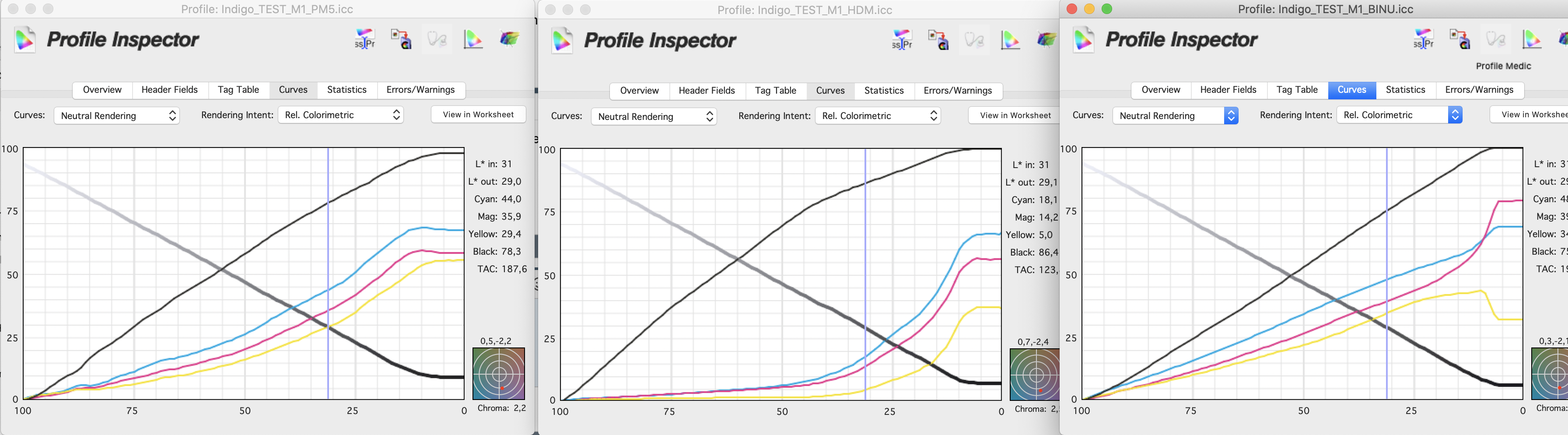

A colleague of mine was helpful and generated three ICC-profiles from the following profiling softwares:
1. Profile Maker 5
2. Prinect Color Toolbox
3. Binuscan Profiler
It seems like the problem (or anomaly) is indeed i1Profiler...
