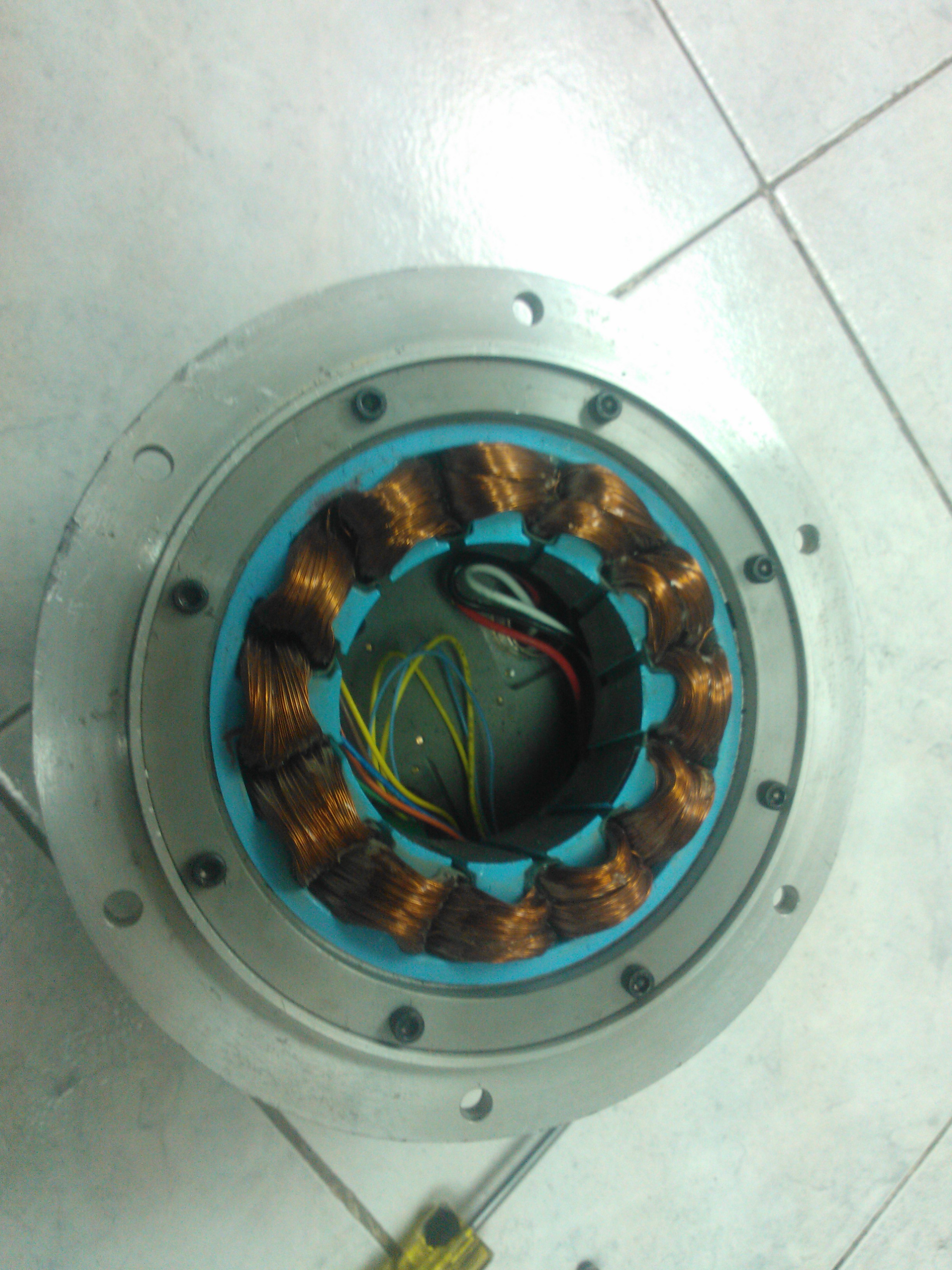

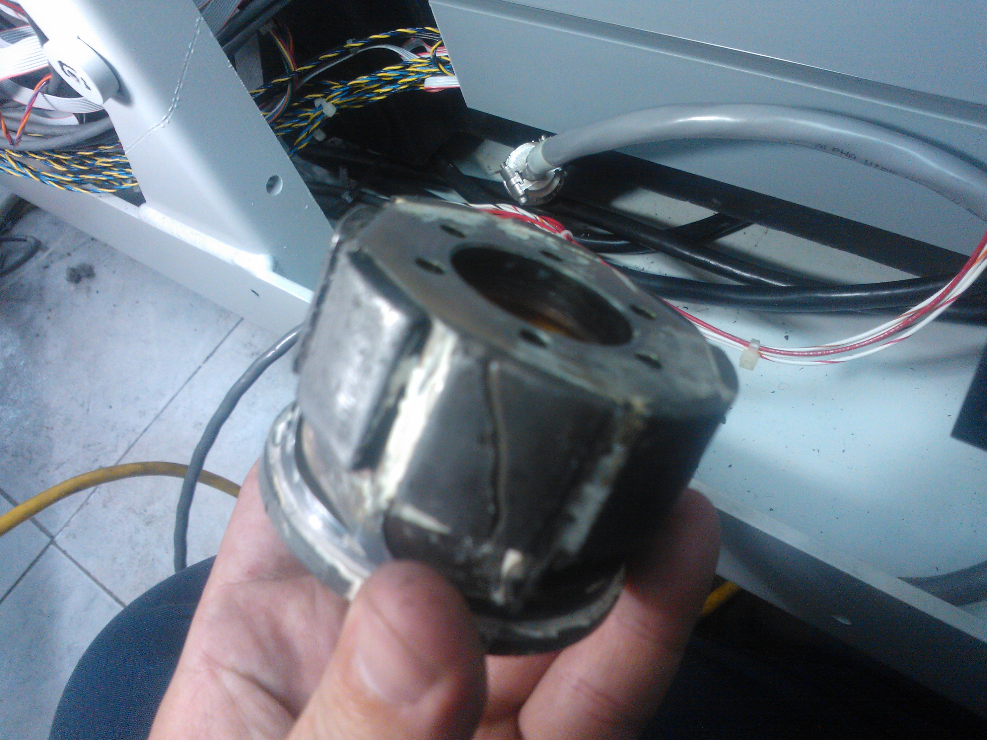

Dear Farshad
repair the motor armature as you discuss one of the magnets was misaligned and three more loose

Dear Farshad

You repaired the the motor armature. Which motor is that?

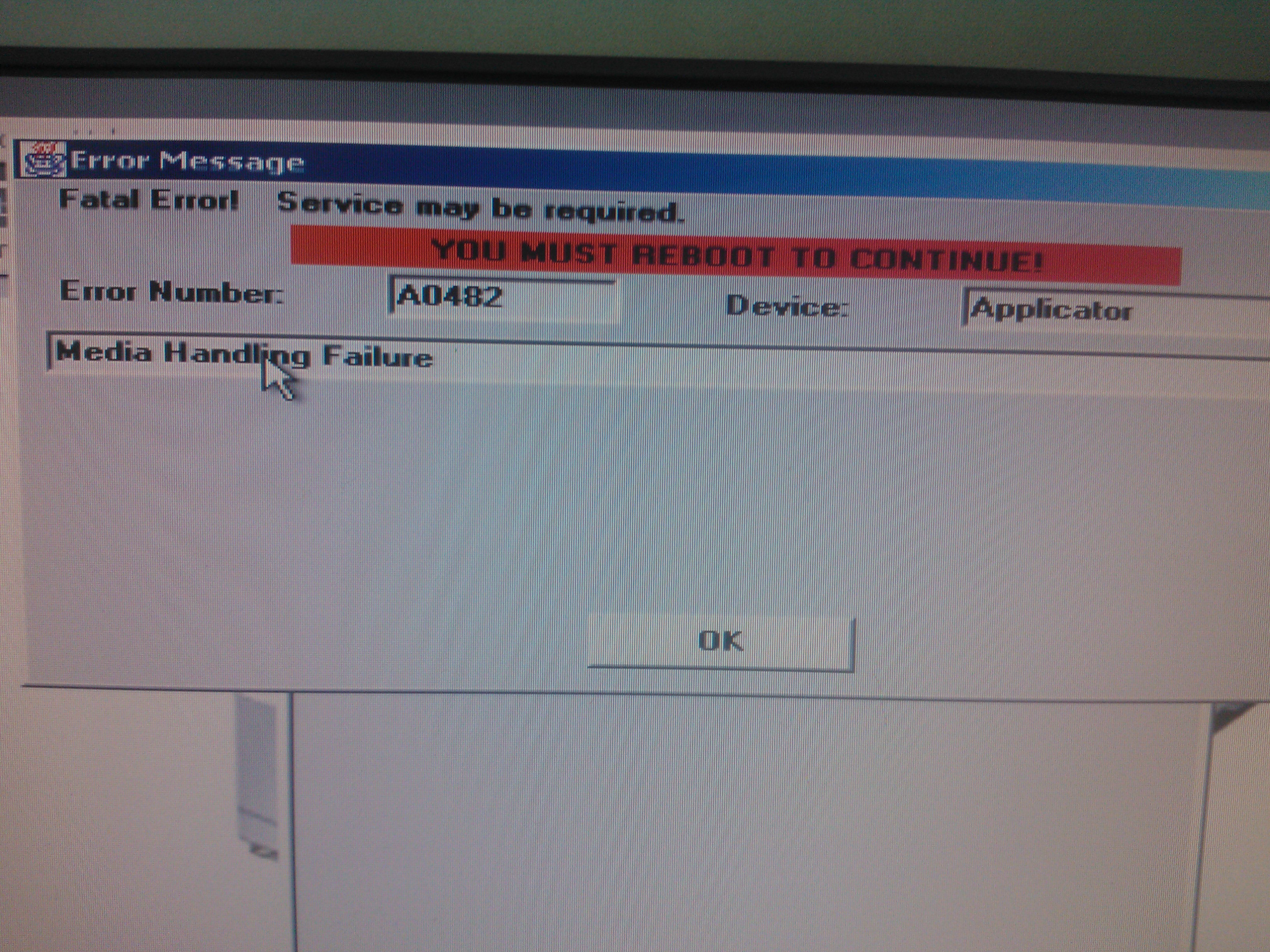

dear farshad
repair as the engine that moved you comment armature magnets, the paste and mounted again, however still gives me the error A0482 in some cases before the A0301 me, eh been reviewing all but really do not know what is the origin of the fault, a sensor could be moved, a communication failure.

dear farshad
dear farshad
Dear Rafael,
Hope you have done proper repair on this. Proceed with the Drum alignment and follow the procedure in the service manual.
