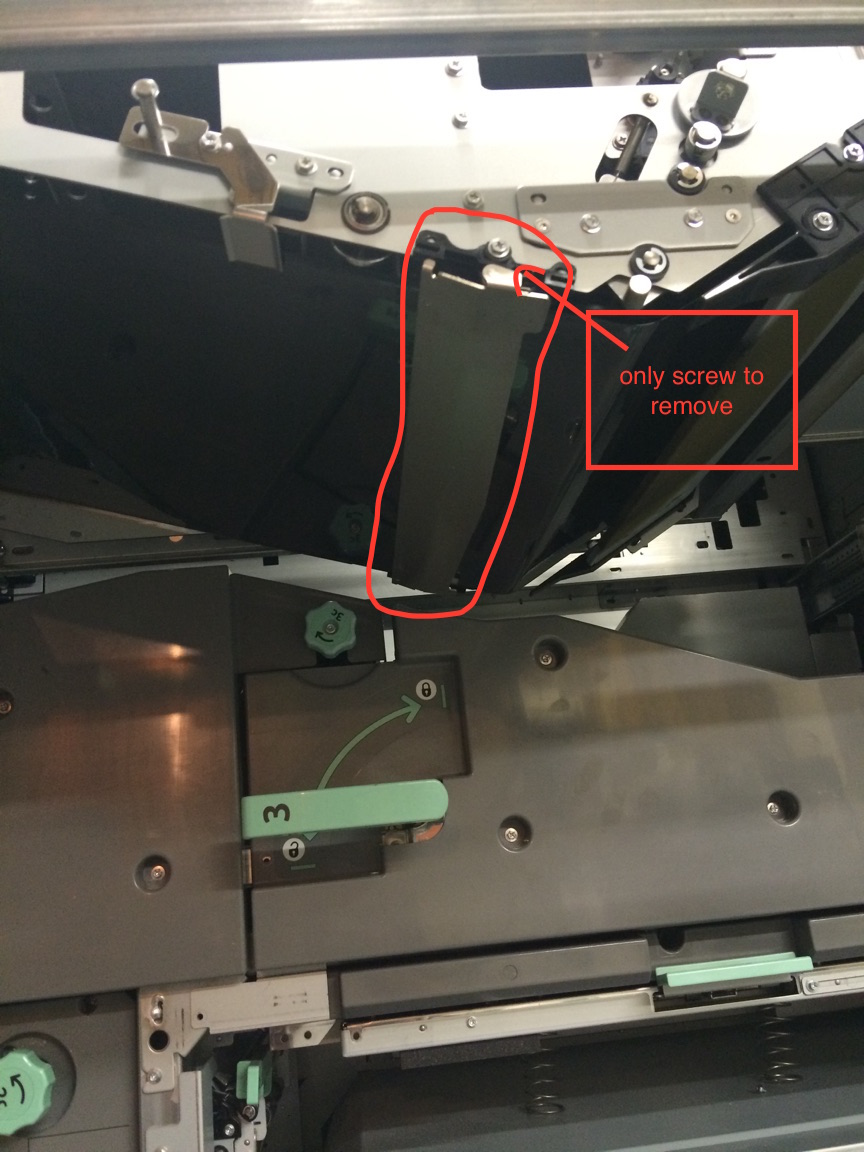

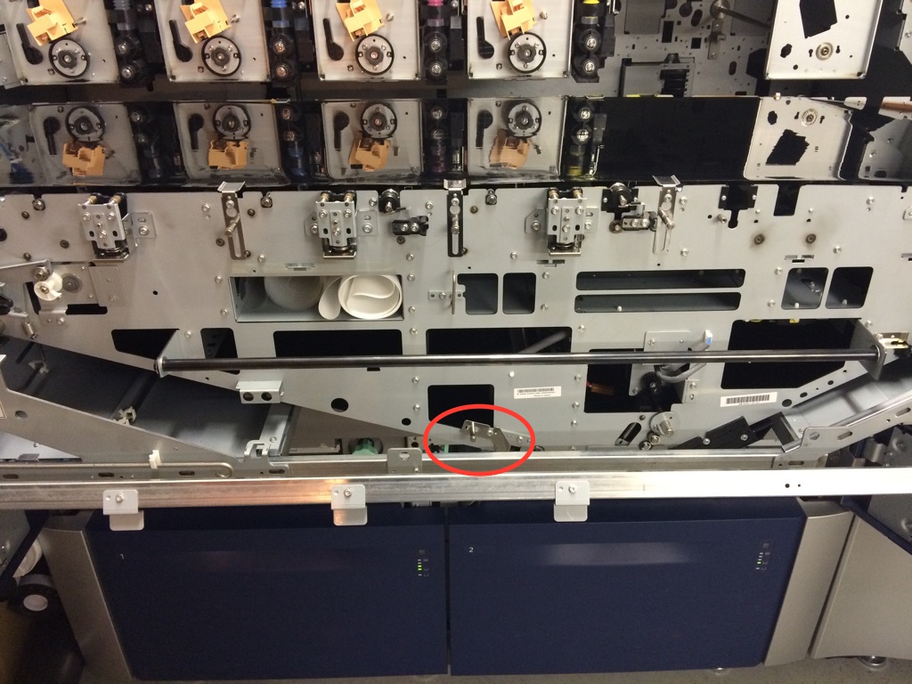

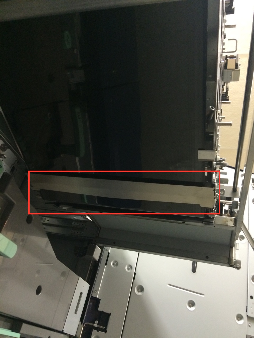

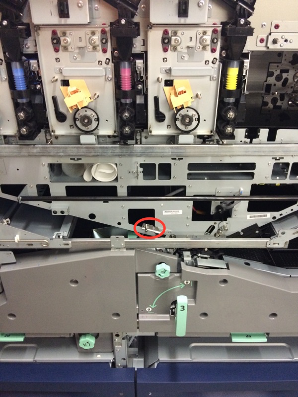

Made some huge improvements today when messing around on the machine with the tech. Was having this problem showing up on heavy coverage on some 13x19 14pt gloss stock. We messed around and ended up taking out the heavyweight baffle in the 1st BTR (i believe thats where it is). Ran a few more and while it was not completely gone, it produced quality that i would not hesitate to sell. Honestly, all but your most critical customers wouldn't even notice. The baffle is simple to remove, and if you leave the covers off, it will take about 1 minute to remove and take care of the trail edge bleed. Hopefully this helps you guys having this problem if you haven't already found this out.
I thought the heavyweight baffle replaced the baffle at the bottom apex of the ibt belt right before the 2nd btb? That baffle makes a curved mark at the tail of the sheet on heavyweight stocks if you have image there. Haven't really noticed it making the tail edge blurry. I thought the point of the heavyweight baffle was to eliminate that mark? I'm really interested to know what the heavyweight baffle looks like. Any way you could post a pic of it?
Your correct on where it is. I was mistaken on that. But it is what is creating the curved mark on the sheet. We just ran the stock without a baffle at all and it was the best print. Didn't jam either. I'll post up a picture tomorrow if I have time. Removal is simple.
That's cool. I am interested in seeing the baffle because we do run short sheets and have the problem with the mark. When we take the baffle off though we have issues with toner waste streaks showing up on the sheet. I think the baffle keeps the sheet from rubbing the ibt before transfer is supposed to occur. We are not on contract so they won't just send us the baffle. But they won't show us what it looks like before we buy it either. We actually do get the trail edge problem you are getting. The only way to stop it that I'm aware of is to adjust the bias transfer in the advanced stock properties. If we're running toner out near the tail we usually have to set it up around 130.
sorry it has taken me so long to reply, but here are some pictures of the baffle to help you out with it. And also i thought i should mention, the one we have installed in the heavyweight baffle.

Thanks for the photos.... very helpful. I don't see a difference in that baffle from the standard baffle. I do see that you have a piece that holds the belt edge down ahead of the baffle. I don't have that on either of my machines. Is that part of the baffle kit? Is there anything else that might be part of the kit? Or is it just the baffle?
As far as I know there is just the baffle that is part of that kit. Mine could be a little different than yours because I have the 1000i. But the only thing the tech and I messed with was the baffle in the pictures. And made a night and day difference really.
OK.... really appreciate your insights. I definitely need to try one out. If anybody has a heavyweight baffle kit they'd like to sell, let me know.
