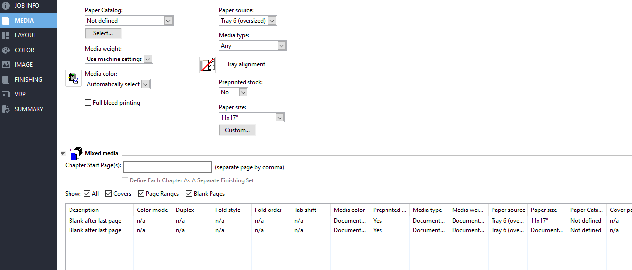

I don’t have an inserter but I had a booklet job in the rip and I just added 2 inserts after the last page (pulled from tray 7) and the counter did not go up for the inserts. Maybe this could be a workaround until they correct it? Add as many inserts as sheets in booklet to get to page count. They do go through the fuser though and add a bit more gloss when doing this.

My goal is to run the entire booklet through the inserter/Tray T1 and avoid the fuser. If I add blank sheets before the fuser, then I have tear them out of each booklet?

Sorry, didn’t explain this well. It’s a kind of convoluted way around what they won’t let you do anymore. You load all your preprinted collated sheets in tray 6 or 7, you're just calling them inserts. You’ll have to pay at least 1 click to make this a booklet but it can be just a black click.
Create a 4 page booklet and then add as many inserts as you need to complete the booklet.
Unfortunately you're correct they will go through the fuser but you won't pay for them.
yeah, thanks, that's what i'm doing
however, I have more jams going through the fuser than bypassing the fuser using just the inserter, Tray T1. And a jam on a multi-sheet booklet is annoying to clear.
