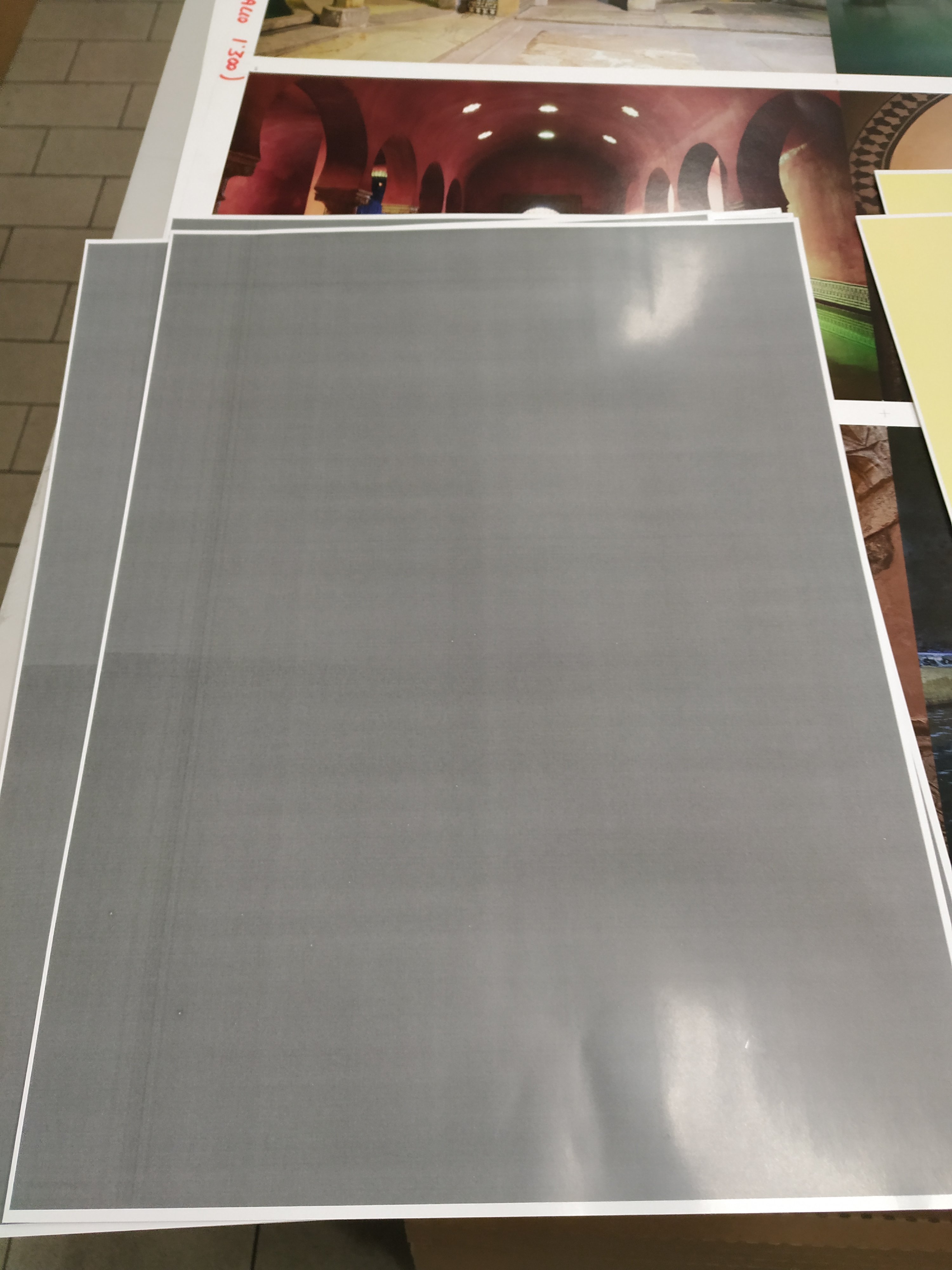

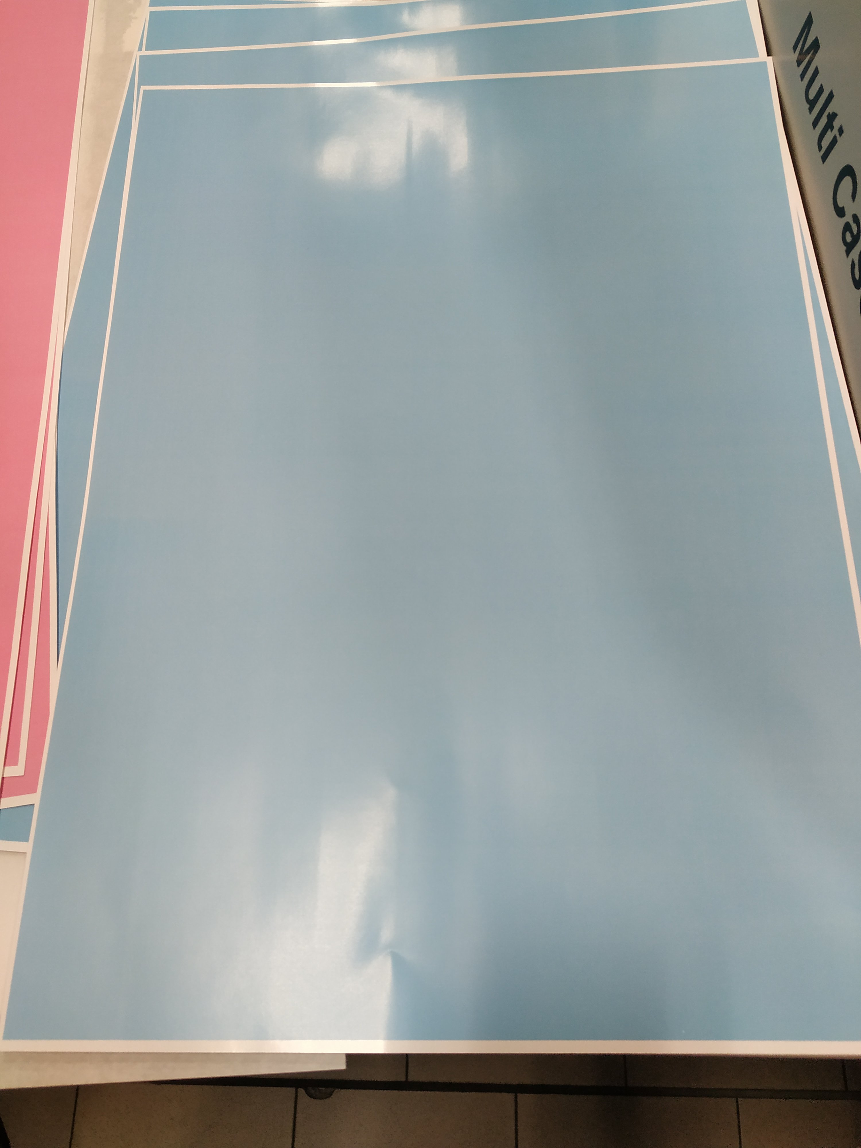

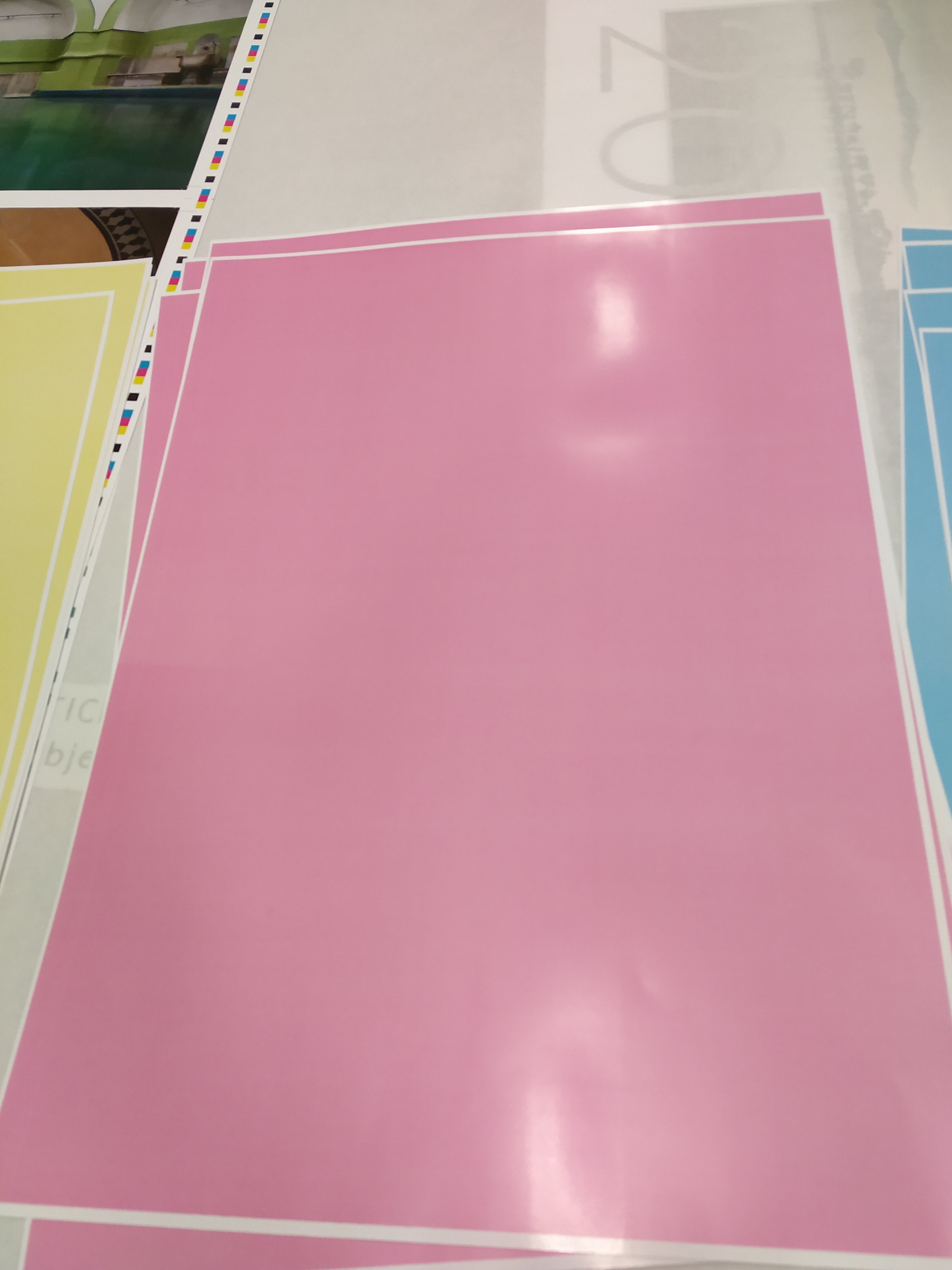

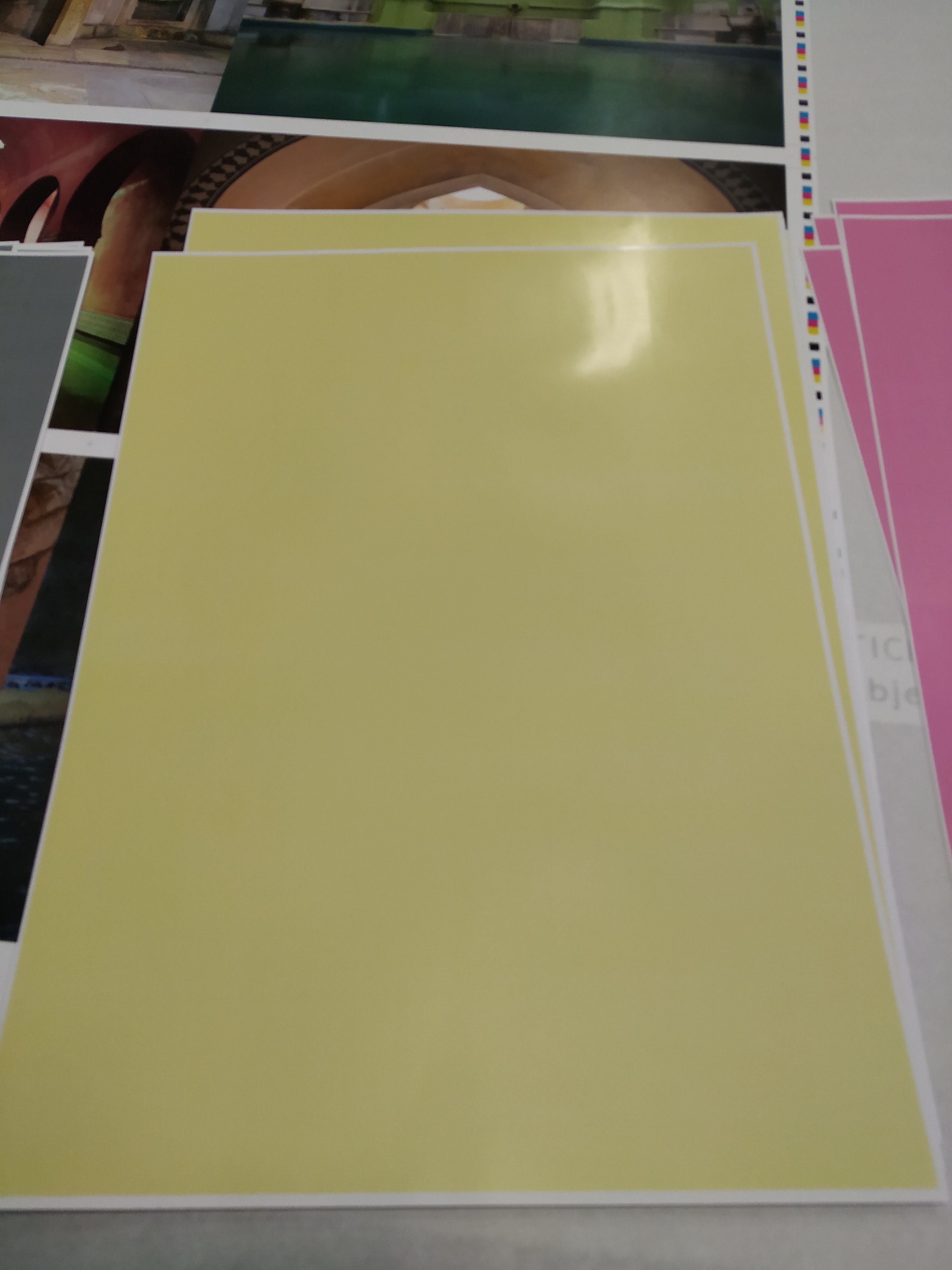

got a strange problem with my old V80. Some strange banding appears perpendicular to the paper path.
It shows 5/7mm grainy band and every 5/6cm a darker band. I noticed it especially into blu and violet.
I have changed several drums but it doesn't solved.
The tech guy did some test and said "this is in Xerox standards"… I have some great doubts about it.
Any idea about it?
Thanks a lot for every hint and advice you can give me!

Gianni_S
P.s.: Drums are new, develop unit were replaced in mid october by the tech guy.
Notice a dark halo on the left side of every sheet, that fades towards right.
