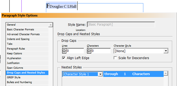

I'm not finding any way to define bold, italic, etc. in the actual QLingo...
However, if you use Paragraph Styles it is possible to use a use a Nested Character Style that only applies to the first character of the paragraph. I've attached a screenshot of the option in this post. You can see the highlighted content object above the Paragraph Style window. For Character Style 1, all I defined was Bold and a larger point size so it would be more obvious for this example.
p.s. this is IDCS5, not sure if the nested character styles are available in CS4 but I think they should be...
