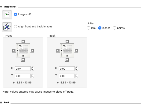

Mine holds register, but do need to shift initial back up
