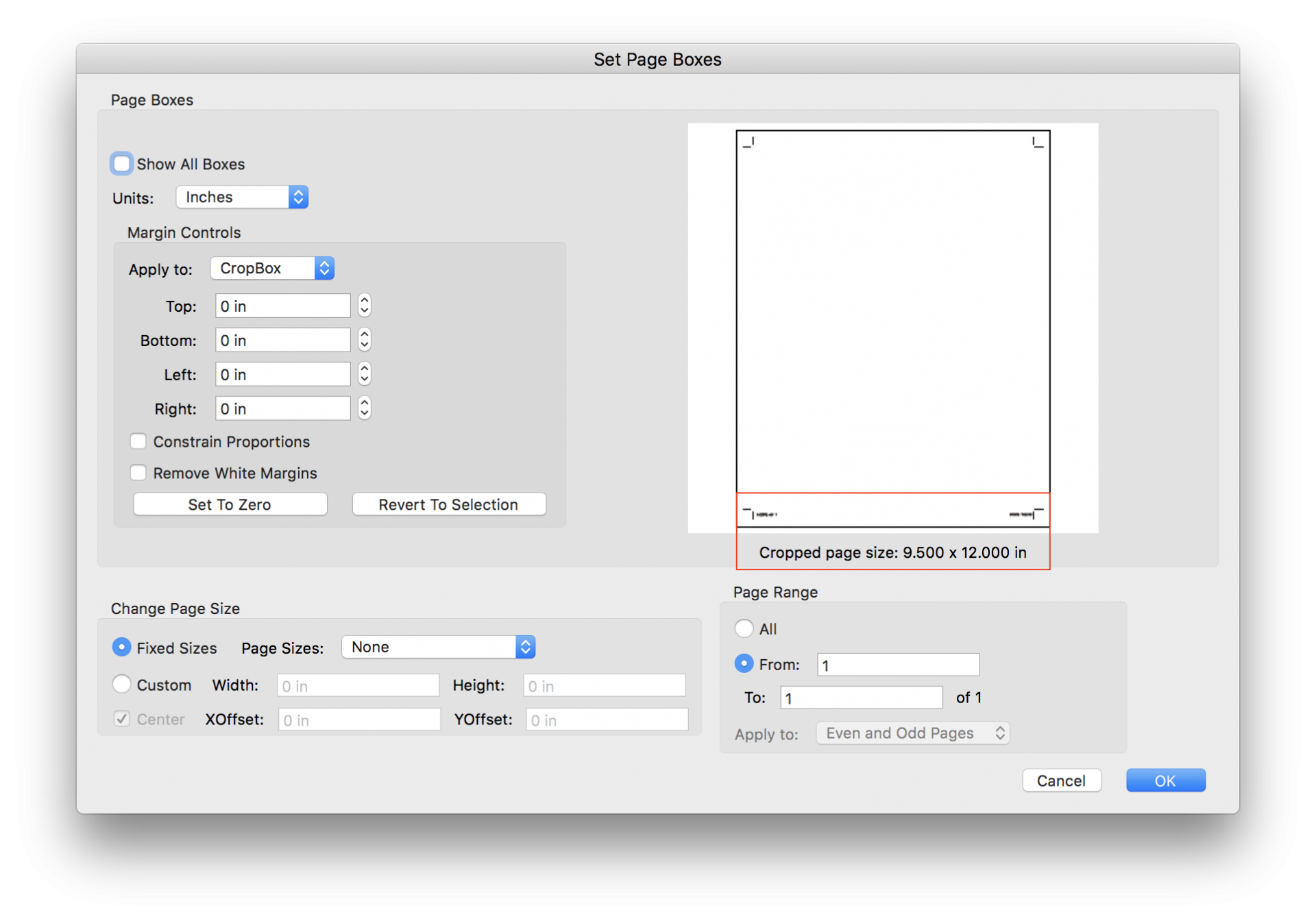

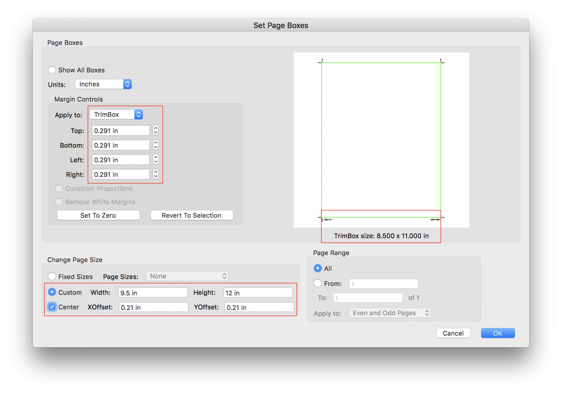

if i understand
kaiserwilhelm’s plight correctly … his customer needs a 8.5x11
(trim) page, and routinely applies .291” bleeds to all his jobs. thereby, customer’s *.pdf file contains 9.08x11.58
(media) … whereas
kaiserwilhelm needs 9.5x12
(media).
customer’s file: media-size: 9.082 x 11.582
trim-size: 8.5 x 11.0
offsets: -.291 x -.291
bleeds: 9.082 x 11.582
revised file: media-size: 9.5 x 12.0
offsets: -.499 x -.499
when adjusting, follow screen-cap
“processing_revision(adjust)” … the dimensions are only for the file-dimensions mentioned by
kaiserwilhelm. the revision took place utilizing acrobat-pro-dc’s cropping interface
(not pitstop) … file created from indd-cs6. pls see attached screen-caps and *.pdf files … feel free to test as example
(s).
