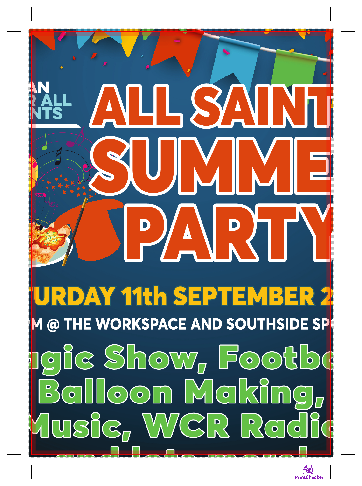

Outlined fonts wouldn't be detected nor graphics containing text. This can only be checked organoleptically. We solved it in such a way that the client could judge it for himself
