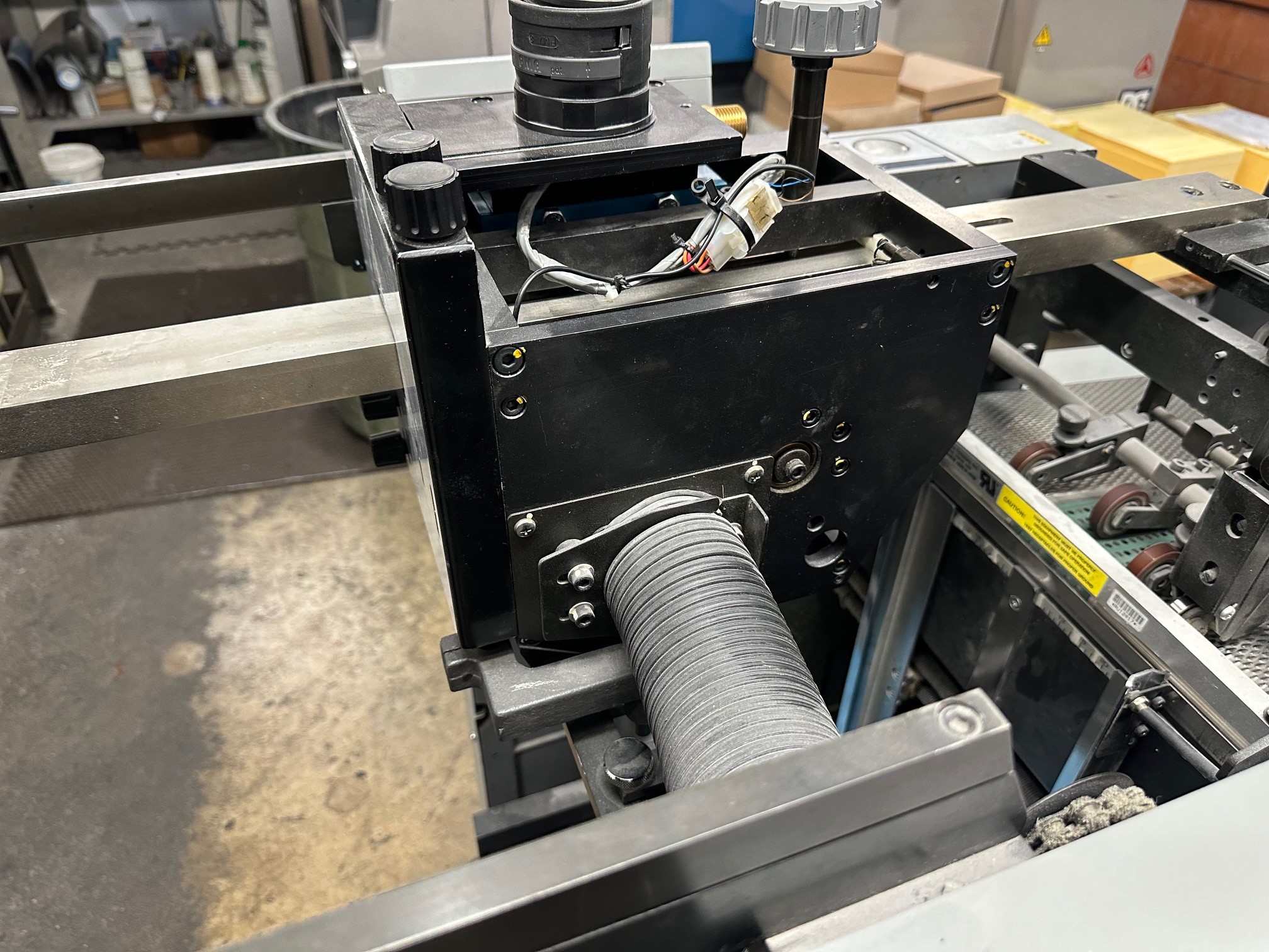

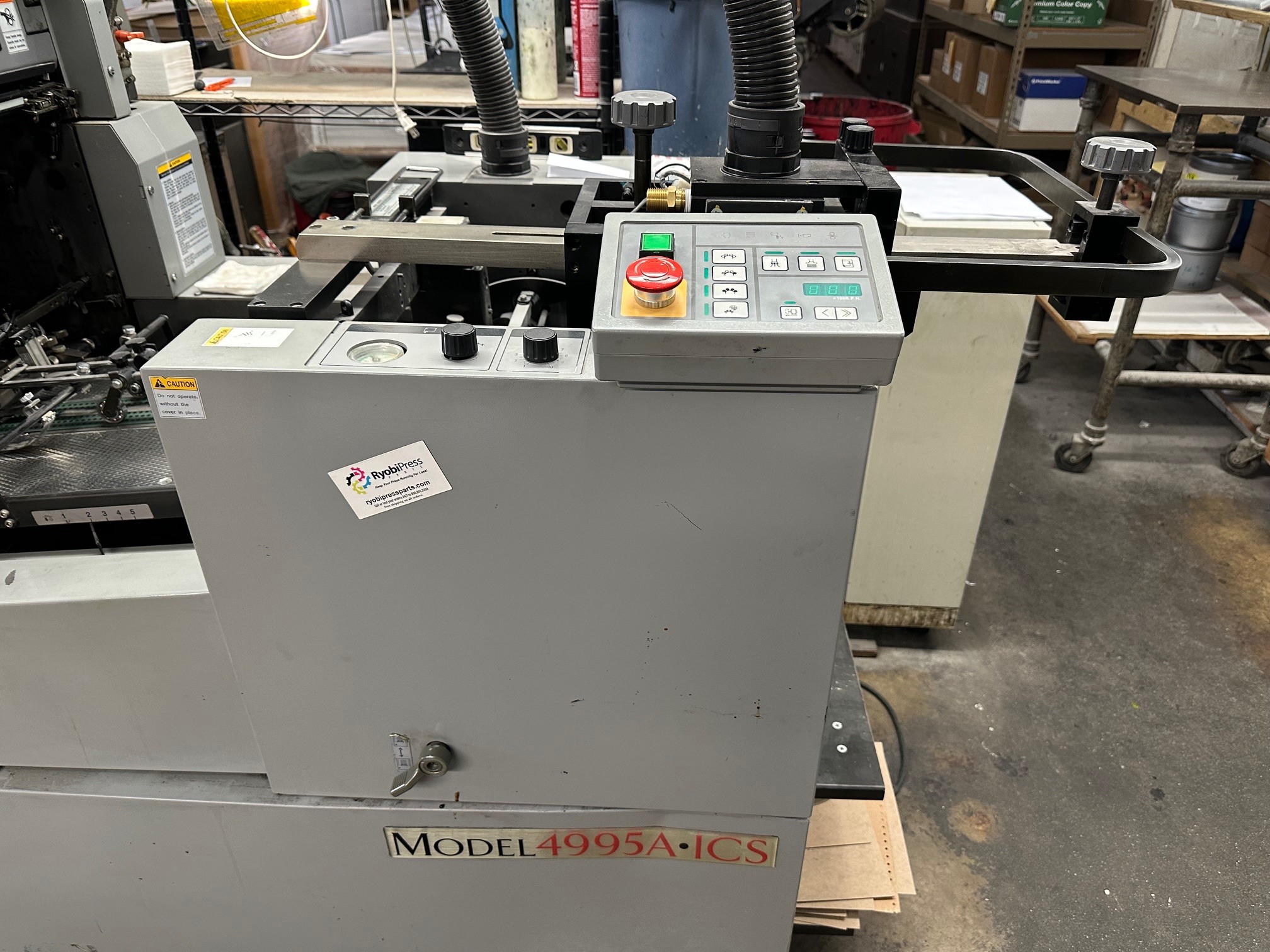

Hopefully Im posting in the correct forum but I'm hopefully someone can help me with our AB Dick 4995. The suckers on the press wont come down to suck the paper anymore. I few techs have came by to check it out but every single one of them have thought it was a ryboi 3304 because its a similar press. Any help is welcomed or even a recommended tech to come help us out.

Check to make sure there is good air/vacuum from the pump. I think it was one of the aux. pumps
Clean sucker and put graphite on sucker tubes.
If that doesn’t work clean valve on stream feeder head.
Hopefully that will do it.
Ill try it out right now and thank you for the suggestion, i really do appreciate it
