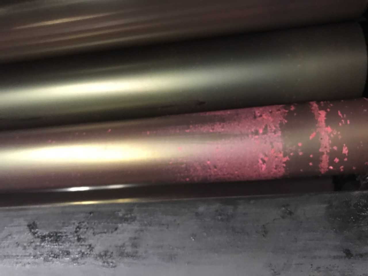

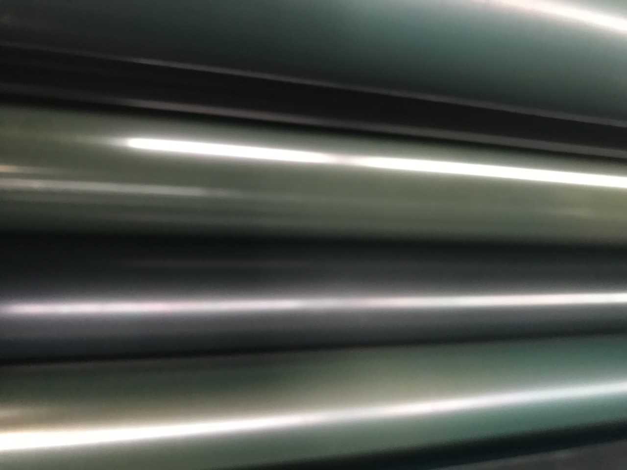

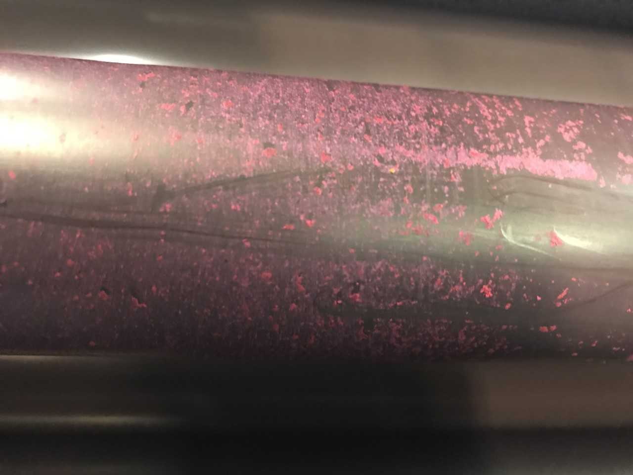

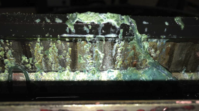

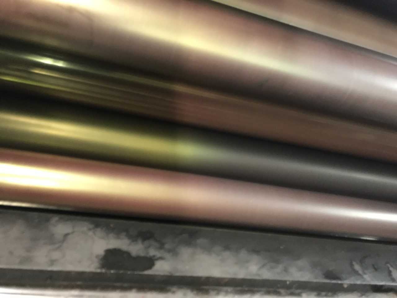

Some roller cleaners contain microcrystalline silica , which is an alpha quartz found in the earths crust and is an abrasive. Clay like properties and appearance is how I would describe it, though I am not an expert on the subject matter, but have researched them extensively and distribute some of them.
There is a new two-step roller cleaner that contains no abrasives and is completely safe for the user and the environment, while providing cleaning abilities never before seen.
The product will dramatically improve ink/water balance and ink transfer. I am a supplier so please private message me for more information if you are interested.
Non-abrasive. Completely safe. No solvents. Roller CLEANER.
