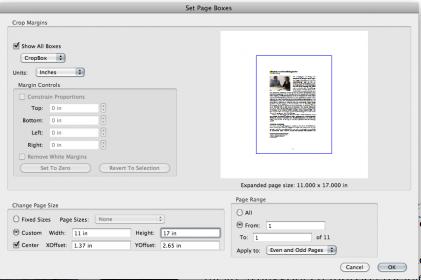

Here is a screenshot of where in crop tool

You may want to make sure you have added cropmarks first ;)

Advanced > Document Processing > Batch Processing > New Sequence >
Select Command > Page / Crop Pages > Add > Edit etc.

I have looked at Acrobat. In the thumbnail, it looks like it is stretching the living crap out of it! I want the same size image put onto a "cavas" of 11 x 17
Yes, the thumbnail appears distorted but if you actually follow through and click OK you will see all is well.

You are correct. The thumbnail DID appear distorted. However, when I pulled the trigger, again, you are correct. It did exactly what I needed.
