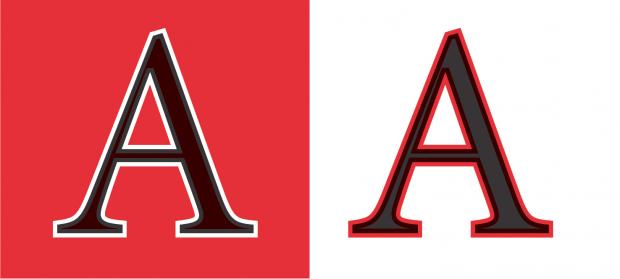

Dov,
If you're able to convince the Indesign people to change the PDF export behavior for stroked text, I would also suggest to them a few more changes:
1) If text has a fill other than none or white and a stroke of zero width applied, to omit the stroke (this often causes undesired hairlines around text and is always unintentional in my experience).
2) If the text fill is 100% of the default [Black] swatch, do not set it to overprint if it has a stroke of non-zero thickness, even when "Overprint [Black] Swatch at 100%" is turned on, as it usually is. I've attached a slightly exaggerated example of what the current result is.
