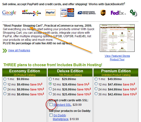

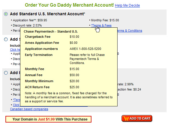

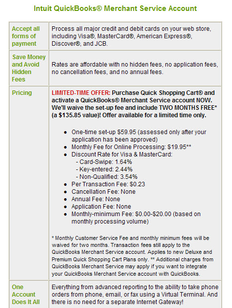

Oxburger is right, there are a number of pieces to this, not the least of which is an SSL certificate. If, as you say, you already have a web ordering site, most of those parts should be in place. Maybe all that's missing is the PayPal business account oxburger mentioned, plus a basic merchant account. You'll probably want to offer both. Yes, your customers can use PayPal and have the order charged to their credit card, but most will prefer the conventional way of just keying in their number into a merchant account. PayPal is usually used in lieu of a check. Having a secure site (SSL) for either of the two is a must.
If you're using QuickBooks, look into Merchant Account & Credit Card Processing from Intuit, which lets you accept credit card payments right in their software. Also check out Merchant Accounts -- Online Credit Card Processing from GoDaddy.
If you don't have a shopping cart, you'll need the whole package: Shopping Cart with a dedicated IP and its own domain, SSL Certificate, PayPal, and Merchant Account. Here too, I recommend GoDaddy. We're just in the process of setting up our own cart at Home - Printfirestore and had the whole thing up and running in a just a couple of hours. The only mistake I made was to use an existing domain name that wasn't hosted by GoDaddy. I ended up having to go through Tech Support to modify the A record for the dedicated IP required for the SSL certificate. Had I transferred the domain name to GoDaddy beforehand, or just set up a new domain name with them as part of the package, the whole process would have been automatic. As it turned out, it wasn't a big problem because their Tech Support is superb.
FYI, I'm not in any way associated with GoDaddy. In fact, three of our five sites are hosted by BlueHost.

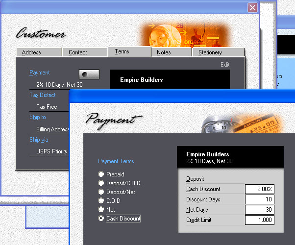

Conventional systems perform what is called an "Authorize/Capture" where the credit card is authorized for the purchase and the funds are captured (transferred to your bank) in one step. For printing companies this would actually be against the rules, as funds are not supposed to be captured until delivery is made.
Not against the rules, David. Cash with order (prepaid) is a very common payment method in the printing industry. And not just for web-based companies such as VistaPrint. No print shop owner in his right mind would accept an order from a new walk-in without getting paid up front. Those that do won't do it for long. All it takes is a little hindsight - the memory of a couple of cartons of letterheads and envelopes collecting dust in the pick-up corner because the start-up with the big plans decided to start up some other day.
The rest of your post is right on the money (pardon the pun). So far, every web-to-print shop I've visited tries to emulate a brick and mortar store. VistaPrint included. It will take a pricing engine easy enough for the average consumer to use to take us beyond the "predefined products at set quantities" business model.
Hal Heindel
