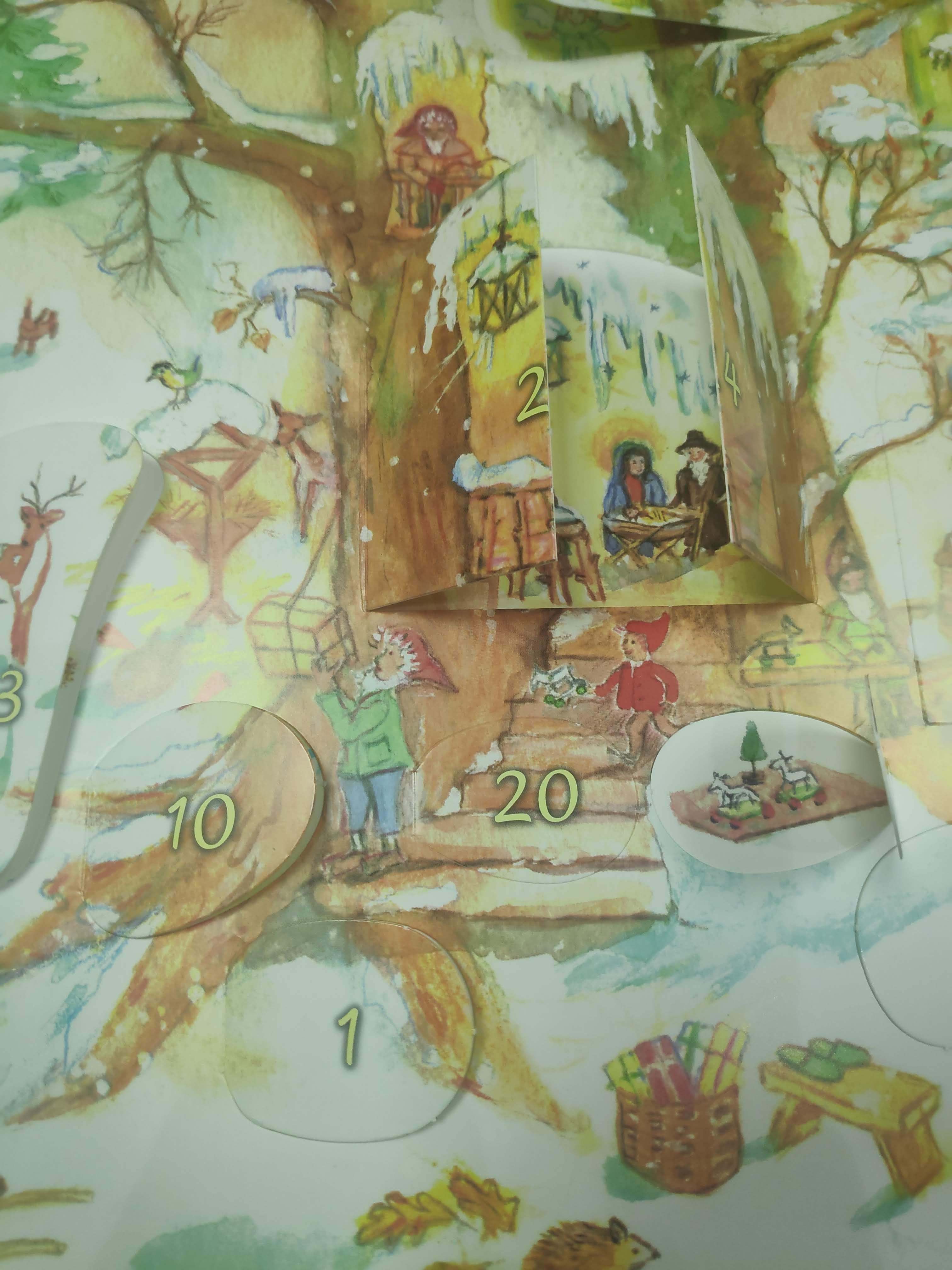

Dear friends,
Who knows how to make the Adventskalender?
Or better to ask, how to stick the 2 carton boards to each other
selectively? I mean how to avoid the glue applying on selected
parts like doors, windows, etc.?
Please see the photo in the attachment.
I thought maybe it should be by "printing" a special glue in an offset machine
using a plate, like in regular offset printing but using a kind of glue instead of ink.
AM I RIGHT?
So please, if anybody has the info of such kind of glue or any other technology,
Please share.
Thanks,
Zamir.
Puch
There are specialized machinery to do that - actually working on the principle what you've described. The low-cost solution is to use a lot of sheer manpower, basically performing the gluing and the sticking by hand.
