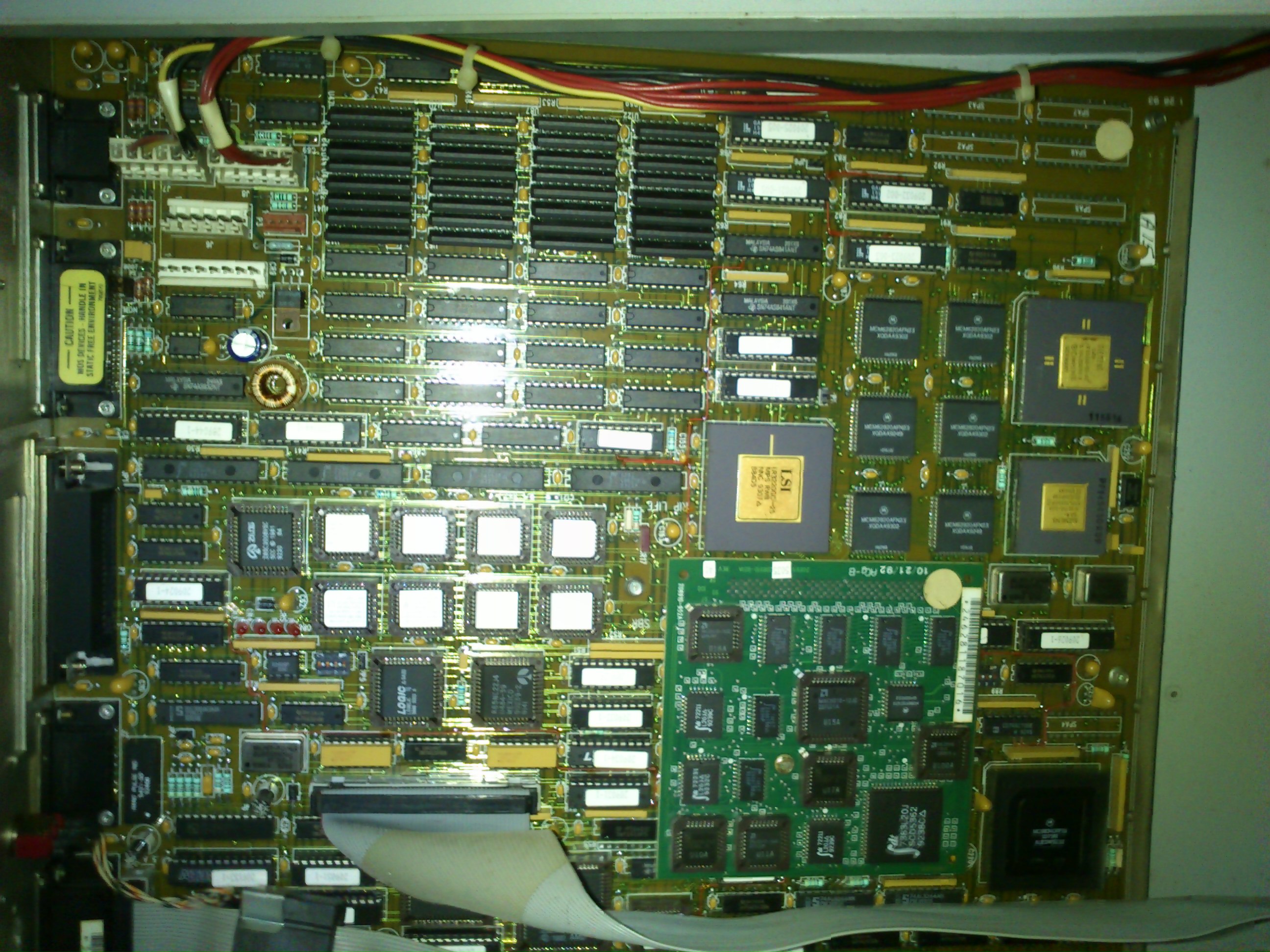

Upgrade is impossible because RIPs Star200 and Star400/600 are single board RIPs or SBR.
Star 200 had less RAM, low bus and processor frequency than 400/600; boards are absolutely different. RAM chips soldered at board, lots of PAL chips were preprogrammed.
Even upgrade kit from 400 to 600 had many chips to be replaced at sockets.
If you send me a photo of your RIP Star200 board, I will tell you what PS Level your RIP has.

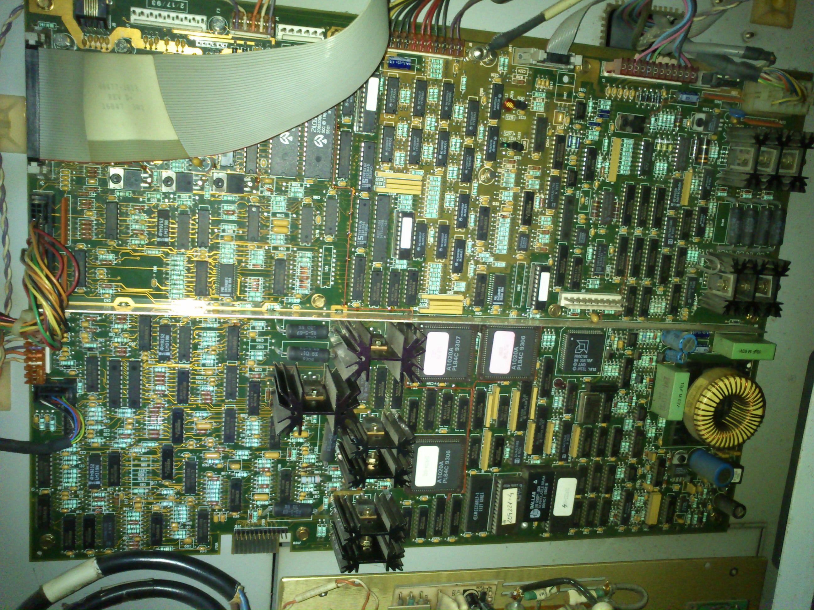

Hi Vlad,
Here you have the Accuset insides...

Photo #2 -RIP : I want to see stickers/labels at 8 small square chips groupped as 4X2. That's a PS interpreter written in the memory chips.
Unfortunately all labels are out of focus :(
But as I remember: if labels were pink or red color - PS L1, white - PS L2.
In case PS interpreter at HD damaged, RIP will use them to complete booting up.

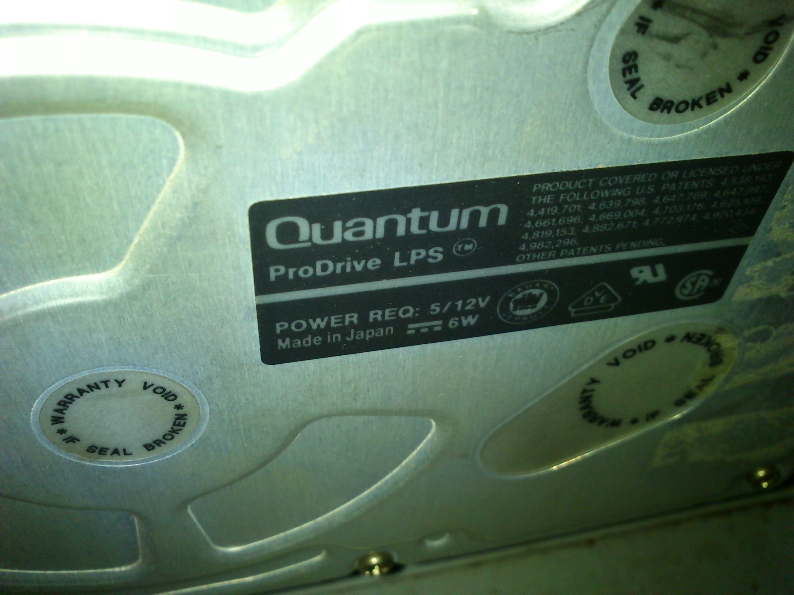

And ByTheWay, what the model of SCSI HD? Just to understand the capacity of it.
Hi Vlad,
I can not take a clear picture of that part because is to dark and the chip labels are reflective.
The chips have white labels, with the following text:
PostScript v2013.108
1984-1193 Adobe Systems
209517-0001
and each chip has a character string to identify its possition (I guess): LL1, LL0, LMI, LMO, HMI, ...
is it enought to identify PS level?
Thank you Vlad!
Level 2.
Check any printer PPD with v2013.108 over google :)

The HD (see pic)
seems to be one these Quantum Hard Drive Settings
but I don't know which one (size?).

Do you think you can find 2Gig SCSI HD today?
Star RIP uses it's own filesystem and low level format could be processed at PC, but high level was some specific. I've never tried to format 10G and higher HDs for RIPs :(
