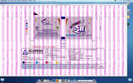

Can ne one help me with this
Please my dear friedns help me with this
problem attached
