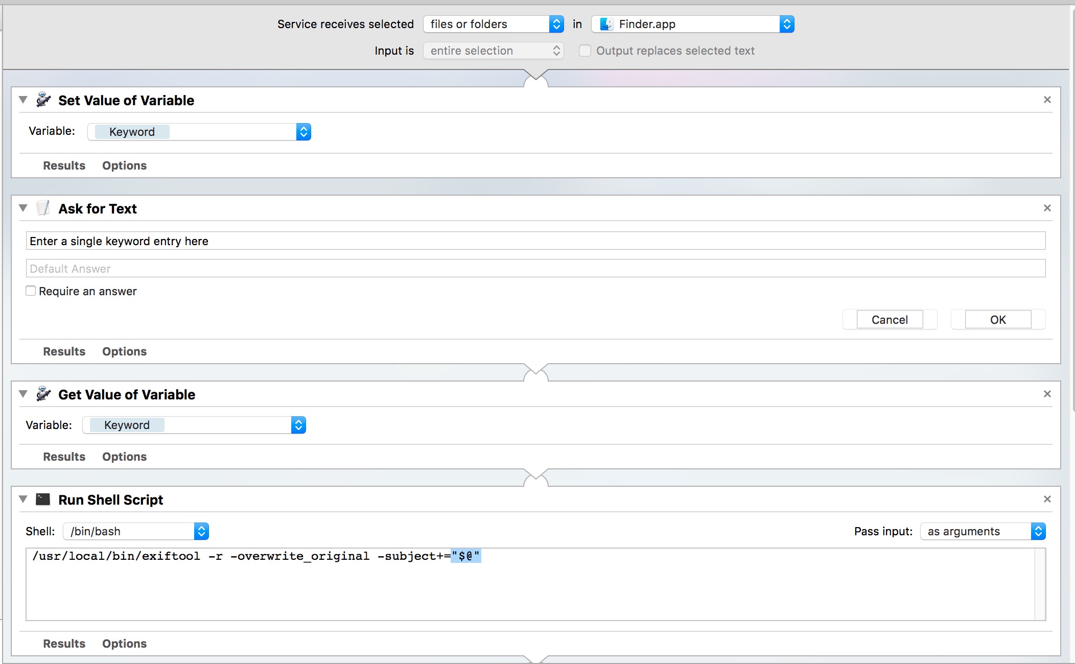

Using Automator, I can run a shell script (bin/bash) as arguments and have a single text variable dialog box appear to be populated by ONE input value.
I have attached a screenshot.
Is it possible to enter in multiple inputs, perhaps separated by a comma? Example:
Keyword 1, Keyword 2, Keyword 3 etc?
How I currently have things setup, if I enter comma separated values a single keyword is created that reads:
However, there should be three separate, individual keywords applied:
Keyword 1
Keyword 2
Keyword 3
I was hoping to avoid hard-coding in multiple variables, as it would vary, one image may only need a single entry, while another image could use more or less variables.
Thanks in advance,
Stephen Marsh

Stephen Marsh
Thanks Tim, this is not a big deal, just looking to tighten things up a bit if at all possible. I was happy enough to work out how to turn ExifTool CLI commands into Services for the GUI, then I thought, hey – how about adding a variable. That worked great with some experimentation. So I then I thought – how about multiple inputs? This is as far as I could take things with my limited knowledge.
Stephen Marsh
Stephen Marsh
The answer was “easy” in the end, I was trying too hard to do this via automator, when it appears that ExifTool already has the ability to split an input string that uses comma separator! Same end result, different approach!
So all I needed to do was add a simple -sep , -sep ', ' switch at the end of my existing command line code and ExifTool will automatically split a comma separated keyword input string into multiple, separate keywords.
So, “keyword 1,keyword 2, keyword 3 etc” will appear as separate keywords, rather than as a single string:
keyword 1
keyword 2
keyword 3
