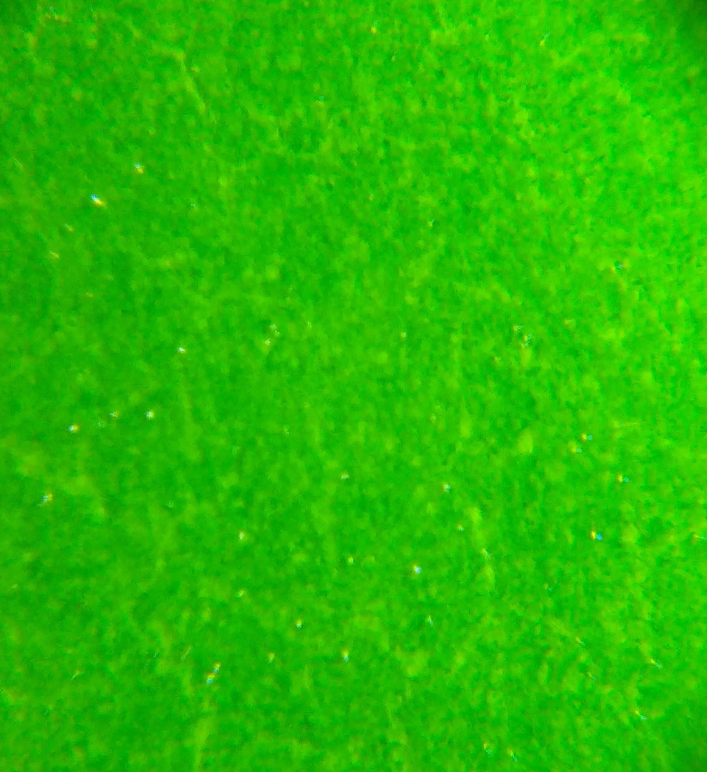

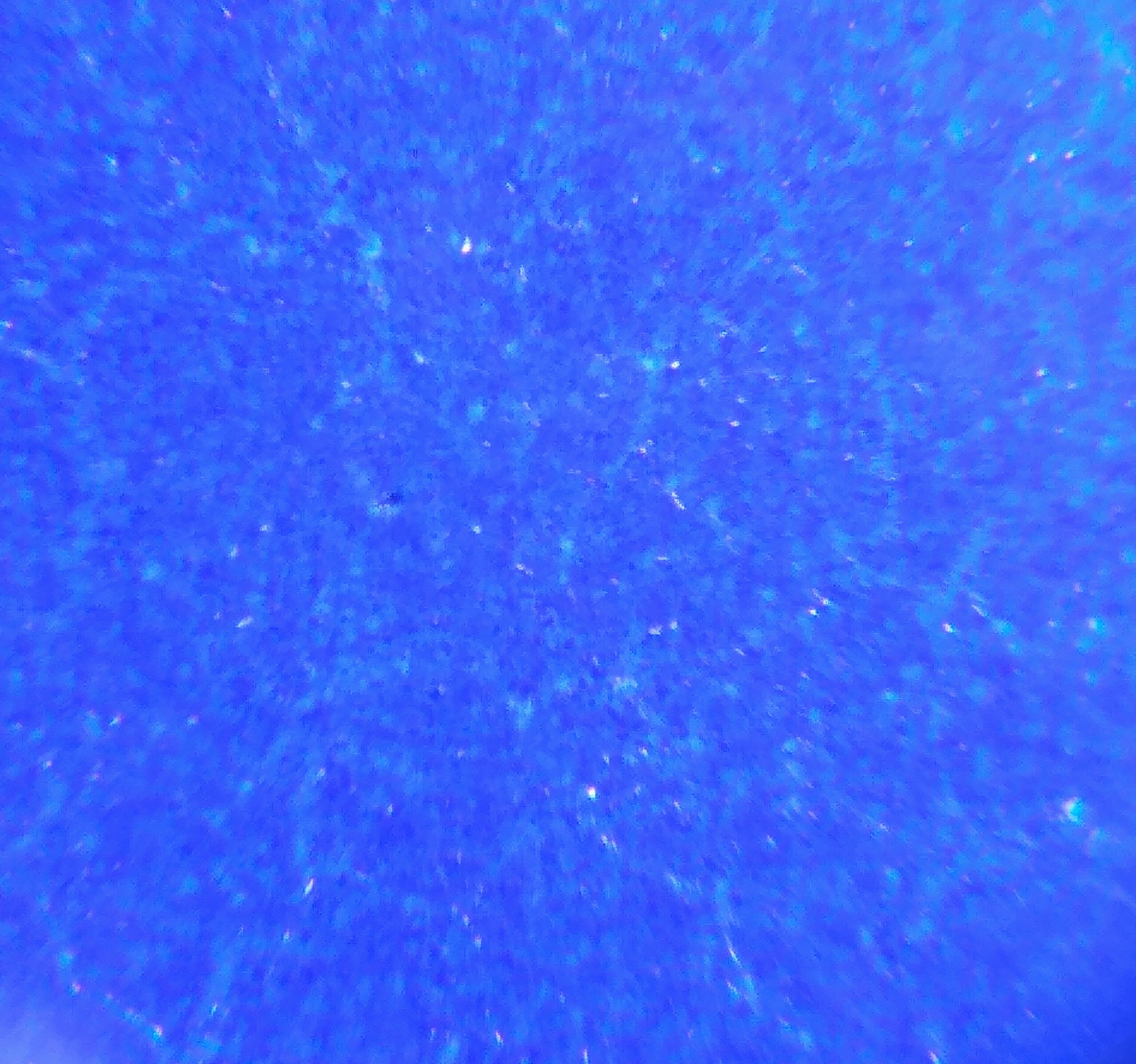

Hi All,
We are facing issue with coating cracks on heavier coverage areas. Low coverage areas have no issue or very little visible.
Please view the attached images of the issue.
The best answer seems to come right from this forum mud cracking", the coating is drying too fast on top of a heavy build.
Make sure the coating is at least 20 seconds (Zahn#3)
Turn the IR's down, along with the hot air knives
Speed up the press
Increase amount of coating (if you have an adjustible coating system)
The coating is drying faster than the ink underneath. As the coating is applied to the film of ink(s) underneath, it's crawling giving the 'Alligator Skin' look. Talk to your coating suppliers about a slightly slower drying coating.
CKL - Good points. If he's running a roller coater, than BCM is irrelevant. He can certainly check his coating stripe and measure viscosity using a Zahn #3.
Aqazi - Is this happening with Gloss, Satin, or Matte? Or all coatings?
